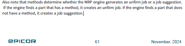

Can someone tell me or point out a document that would tell me why a Job Suggestion would be created and not a Unfirm Job?
I only have a handful of suggested jobs in my system. In all cases it’s because there isn’t an approved method for the system to use.
EDIT: from the MRP Tech Reference:
Note that the tech ref isn’t quite correct. Even if a part has method (and only one method), it must be approved for the system to use it for unfirm jobs.
