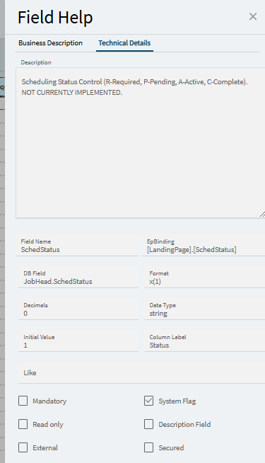

I don’t see any “Job Status” field in either of those versions, either in Classic or Kinetic. There is a field called labelled “Status”, but that field is the Scheduling Status field. Can you tell me what database table/field it is bound to?

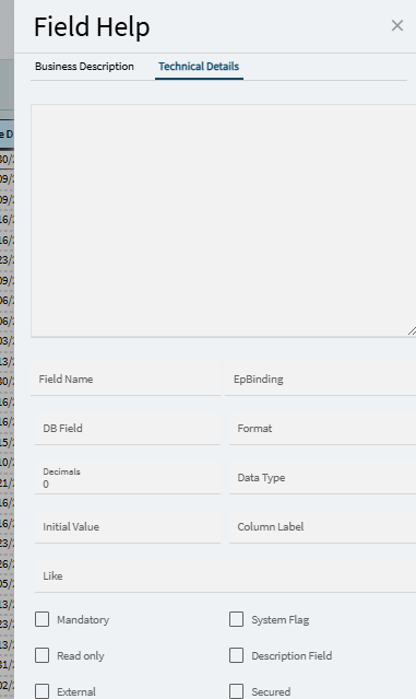

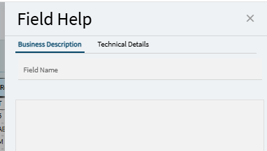

Well this is part of the weirdness that I’m seeing.
There is no information provided about the field at all, yet it is a default field in the Job Tracker screen. Field help shows nothing at all.
It looks like the Status field you noted is really only for scheduling status, and - at least in our version - the help reports that field is not currently implemented. Here’s the info on that FWIW, which isn’t what we’re looking for anyway:
