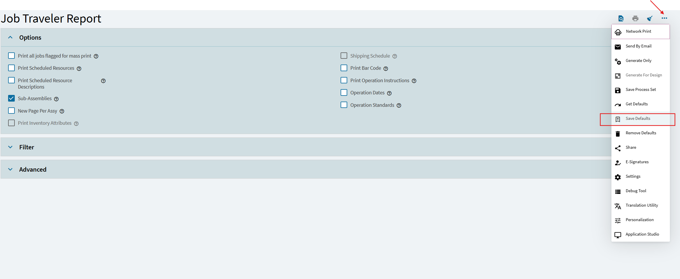

Hello,
Hope you’re well!
I’m looking at setting some defaults (sub-assembly always ticked) for the Job Traveller report, I’m able to do so manually by going to the overflow and saving them there.
But I notice there is also ‘Get Defaults’ which looks to be system set, does anyone know how to amend these please?
Thank you so much!
At least in Classic, I don’t recall anywhere to set defaults.
You would need to create a BPM that is trigged on the Erp.RPT.JobTravSvc\GetDefaults method. You can set your preferred values here, that would affect all users.
