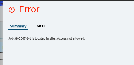

Screenshot 2025-03-07 151629
Anyone run into this issue before of a job with no assigned site?
This was a job from the configurator. There is no site associated with the job creating a error when trying to find it in Job Entry.
How can someone go about deleting a job like this so we can use job wizard to create another job?
I haven’t seen a job without a site before. I would just create a quick Updatable BAQ and change the site to a valid one so that I could either use it or delete it.
It went through with a DMT… I didnt thank about that. THANKS!!!
