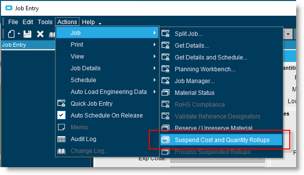

Try turning this ‘Suspend Cost and Quantity Rollups’ on before changing the rows.
Man that seemed promising, but, when checking out the UI, in order to suspend that I would have to un-released, unengineer, make the change, then re-engineer, re-release, do my quantity completions, then do it all over again to change it back… That seems like it would take longer. … sigh.
