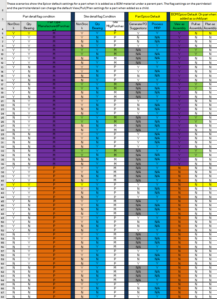

Try understanding Epicors “Phantom, Non-Stock, Purchased, Manufactured, View As Assembly, Pull As Assembly” flags, simple checkboxes that make or break your mfg process. Before we even began to Customize that portion, we ran 60 tests to understand the cause and effect. Not a single Epicor Guide or Epicor Specialist could help us, it was hands-on and practice, practice, practice. I doubt even Epicor knows about it as much as we do now, definitely all the consultants we had were a joke and the only contribution they gave within a 8hr/2 day period was… “Did you know, if you right click the tree, you can resequence?”… “No Sh*t, where were you the other 7hrs to contribute something, while we pay for all your travel expenses” lol Paid 5K for a Resequence Tip.
