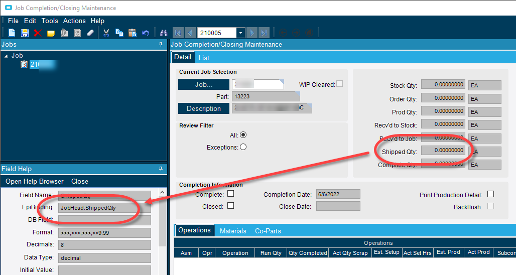

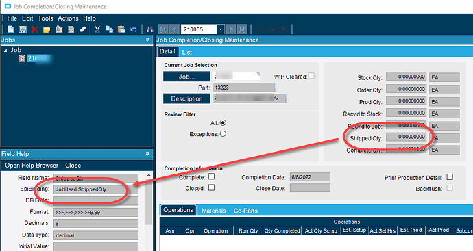

Is there any easy or straightforward way to get the Shipped Qty for a Job? It’s not a DB field, which would be nice.

JobProd table has the shipped / received qty’s
JobProd.ShippedQty
JobProd.ReceivedQty
Thanks!
Also quick tip, if you have the Advanced Production Licence.
You can use the JobPart Table which is a child table of JobHead and a Parent to the JobProd table. which would give you a summarised quantity view without having to do all the grouping and summing associated when using the JobProd table.
