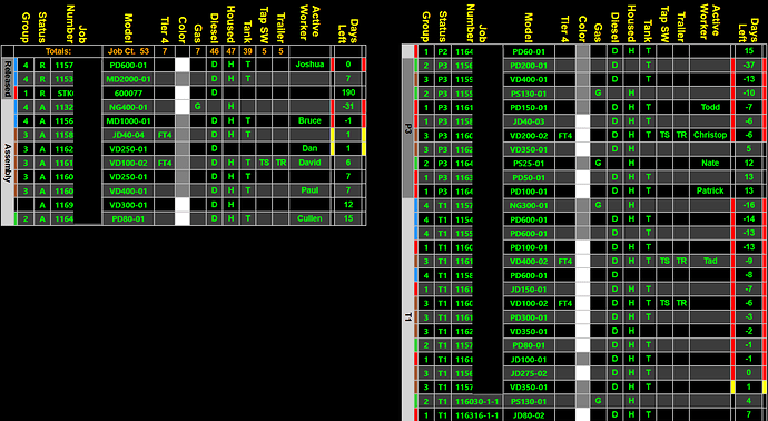

We do this. It started small but now there are giant flat screens everywhere. Management loves it.
We use Microsoft Power BI to display the data now, but the first version was a simple Epicor dashboard, it worked fine.

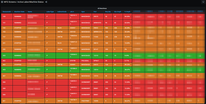

We use grafana with the SQL query driver and just directly pull what we need to display that info.
