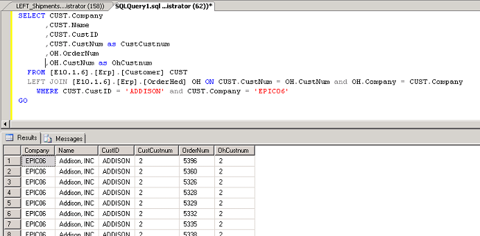

Have you already looked at the CustNum field in the tables Customer & OrderHed?

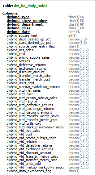

I’ve looked in the Customer table, yes. I don’t currently find a table called “OrderHed” or “OrderHead”, however. I’m currently looking at the full Sales table and it doesn’t contain any columns for things like Cust ID, Customer Name or any other variant of those (screenshot is from MySQL Workbench):

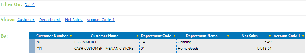

Currently, I still can’t find a way to tie a customer name or account data to the transactions in the Sales table. The Customer and Sales tables must be linked somehow. I can create a report in Compass that includes sales totals for a given date with customer account name and ID number. How that linkage/join is done I have no idea. I should be able to import the relevant tables into Power BI and establish a relationship between them on Customer Name or ID. But the sales table doesn’t contain any kind of customer reference data.
Here’s a sample of what I get from Compass:
Your post is indicating E9?
Is that really your version…do you have direct access to the BAQ tool in the Epicor Client (or the database)? If so, might start in your Epicor client with a simple query on the Customer and OrderHed tables.

I can tell from that pic you posted that that is not the sales table.
That is a report or aggregated table from the sales table.
“dw_ba_daily_sales”
I don’t think I can be of any further help except to tell you to look further up the chain.
That sales table does look like a view or some other kind of aggregated report. Does anyone know the official name of the table containing sales transaction data?

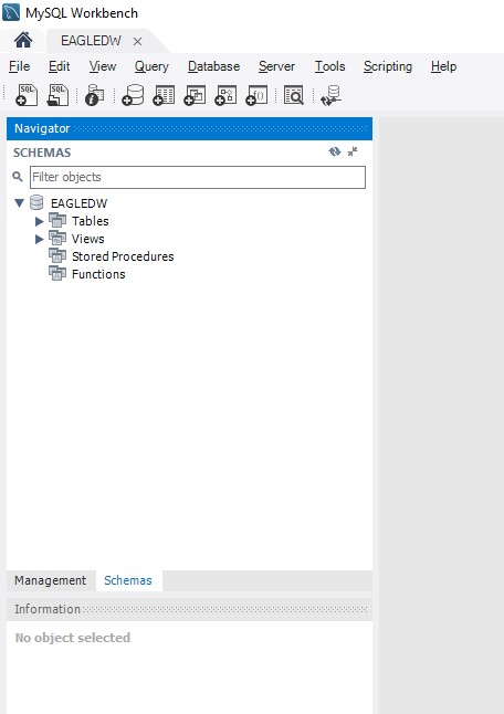

MySQL Workbench won’t connect to Epicor’s database.
My understanding is that the EAGLEDW database sits behind some kind of Epicor front end. It appears to be some kind of Retail ERP system according to the link below.
This is what I’m seeing in MySQL Workbench:
