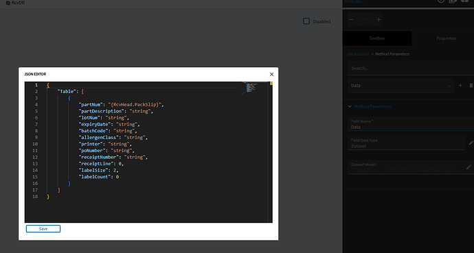

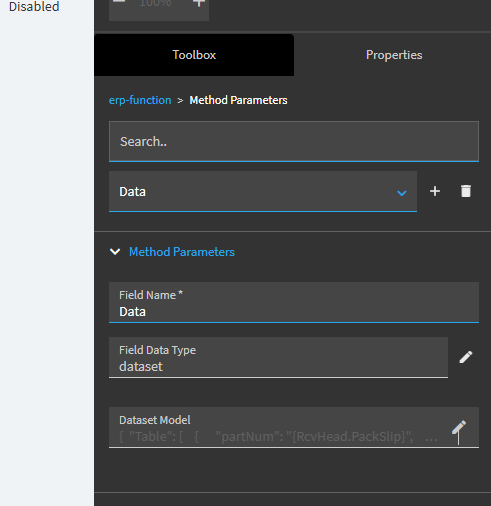

Hi Team,
In App Studio is the json editor able to subsitute in all occurrences?
My example is i’ve added a erp-function and i’m trying to send my function a custom dataset.
The erp-function is just sending “{RcvHead.PackSlip}” instead of the value and I’m not sure if it should work or not.
I’ve had a good look for other posts a lot of questions about the return DS but none about the arguments.
Hey Pat!
I have also struggled with this exact thing.
If I remember correctly, I wasn’t able to substitute within the json editor. Instead, I ended up having to pass either the entire dataview as it is, or pass individual values and then build the ds myself within the function.
If you only have to pass the partNum for your function, why not have this passed as a string param and build the rest of the columns within the function?

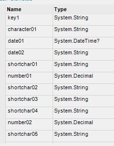

Input param example (the columns I want to update with a value from the calling application)
