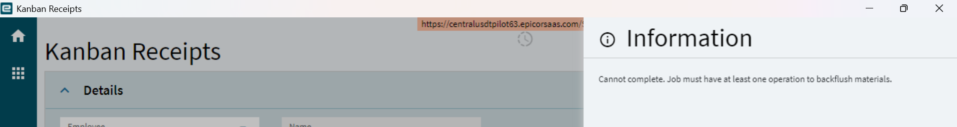

I’m encountering an error when attempting to enter the quantity in the Kanban Receipt and update it. "
I would look into the method for this assembly using Method Track or Engineering Workbench. There is likely no operation set for it which would need to be added in Engineering WB.
You need to add an operation on the method/revision you are trying to kanban in. Could be a completely made-up operation, but it needs to be there.
