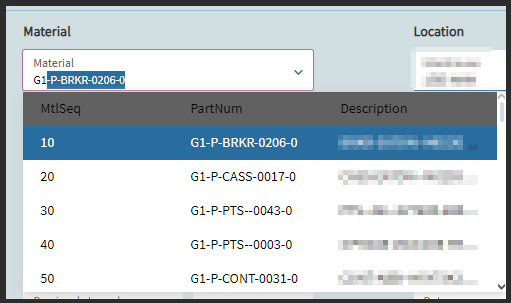

I’m trying to allow us to use our scanning capabilities within the Issue Material App. The App only lets the user key in / select a MTLSeq number, not the part number. Has anyone successfully been able to enter in a part number in this screen? We have EKW and it lets them issue by part number (but we are wanting to move away from EKW)
I’m thinking I may need to add a new text field and once the part number is entered, perform a check to see if the part number is on the job then pull back its mtl seq value and populate the oob mtlsequence view. Hmmmm. Thoughts? Thanks a ton!

Solved!
I needed to create my own sub type from the service defaults and change these two values under advanced combo properties:
The default TextField is MtlSeq
Way easier than my original thought process!
