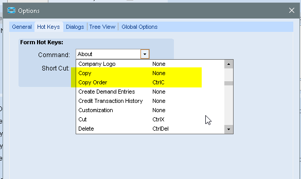

Try setting Ctrl+C to another function in the preferences - obviously choose a safe one.
Then see if pressing Ctrl+C tries to perform the newly selected function. I changed Ctrl+C to “Copy Order” (on the Order Entry Screen):
Highlighting text and then Hitting Ctrl+C makes the Copy Order dialog pop up.
If that doesn’t work, then it looks like something is intercepting that key sequence prior to it reaching the client program.
If it does the new function then the keys are getting to the client program. And maybe switching it back to “Copy” will fix it.

Does the edit menu show the key’s assigned? Here’s mine (after I reassigned Ctrl+C to something other than Copy)
Correct. Clicking Paste in the Edit menu does not work. And yes, it does show the key assignments (which disappeared when I assigned it to another function).
I assigned CTRL-C to ‘Field Help’, and when I hit CTRL-C after closing/reopening the form, the Field Help menu appeared. Switch it back to Copy and it stops functioning.
