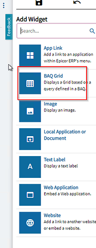

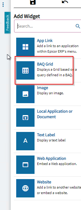

Will users still be able to create BAQ gadget tiles or does Kinetic render them extinct?
Active Home Page does allow you to add BAQ Widgets
@josecgomez, have they added back the ability to place an action on the Widget like we could in the Modern UI BAQ tiles?
For example, we had a BAQ for purchased parts on POs without material standard cost. Click on the row would take you to Cost Adjustment. It was a nice work flow.
