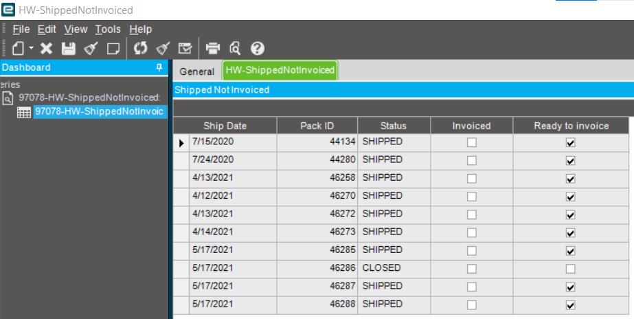

To test out if the tracker is causing the issue in Kinetic 2021.1, I created a very simple BAQ that looks at only the ShipHead table and returns ShipDate, Pack ID, Status, and if it is invoiced. I then made a dashboard of this query. The dashboard is very simple with no filters. Here is what the dashboard looks like:

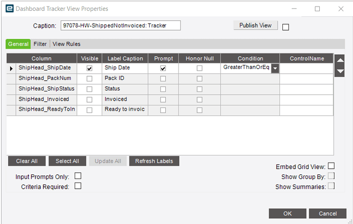

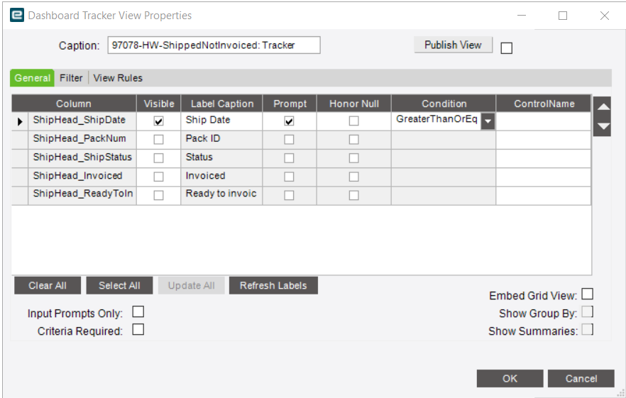

I added a tracker view to limit the date range to greater than or equal to on the ShipHead_ShipDate. Here is an image of the tracker view properties:

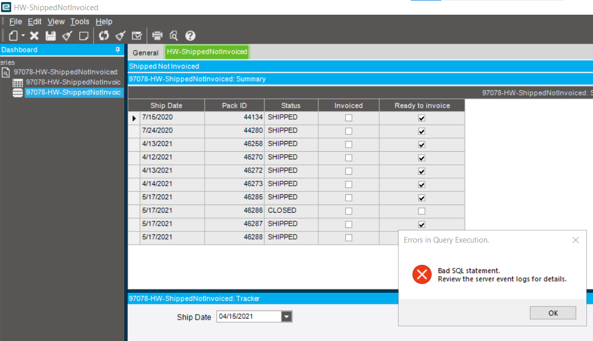

When I enter a date to the tracker and refresh then I get the error “Bad SQL statement”.
If there is no date entered into the tracker field, then the dashboard will refresh properly.
