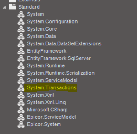

The type 'TransactionScope' is defined in an assembly that is not referenced. You must add a reference to assembly 'System.Transactions.Local'
System.Transactions is already available in reference by default.
