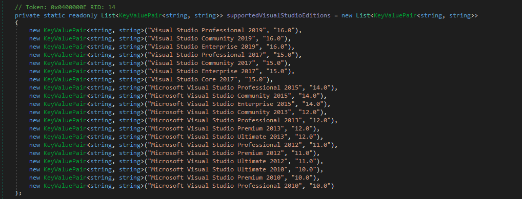

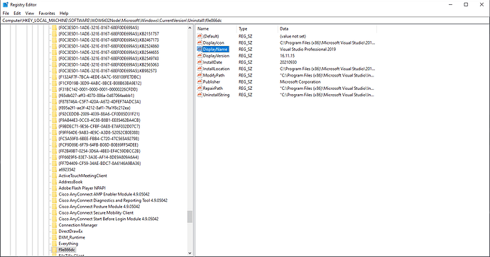

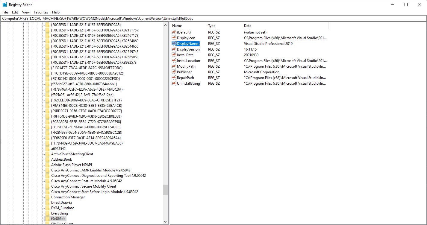

I am trying to test a customisation in debug mode, but my Visual Studio is greyed out.
You might need Visual Studio 2019 or 2022 in Kinetic. I haven’t really tried. Also do you have Community Edition or Professional? I had once an issue with Community Edition.
