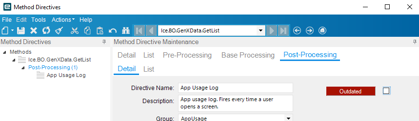

Does the conversion finish or die? If it finishes the bpm should be marked as outdated and you can search in bpm recompile for it.

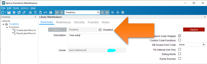

Oranges to tangerines, but when I had an Epicor Function Library do this, the library was disabled.
Is the analog the BPM Outdated/Compatible checkbox?
Edit: And now I am understanding what was already said…
