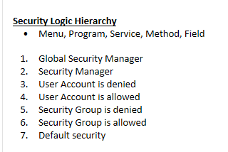

I have this in my notes regarding Security. I believe this indicates that the ‘deny’ has precedence over ‘allow’ so you won’t see it.

So that’s the thing… I have two security groups assigned in the manner above, so even with that hierarchy, I don’t understand why they can’t see Sales Management.

That’s what I observed during implementation. If ‘deny’ is applied by one security group, it can’t be overidden by an ‘allow’ from another. I gave it some thought as a way of encoding separation of concerns but decided it wasn’t worth it. If that behavior isn’t set in stone it can change over updates, and auditing security after updates is already more than enough of a chore.
