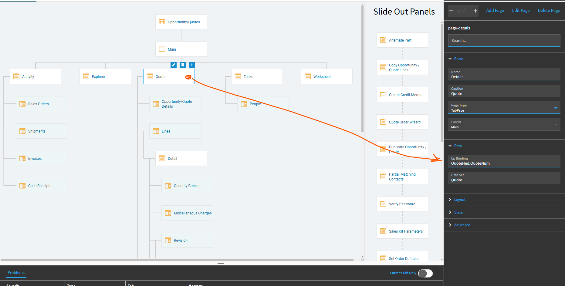

And this issue (from what I’ve experienced, along with others on the forum) is due to a missing EpBinding one or more of the forms.
I would get your custom Quote layer loading first, that’s top priority. And then, if you still don’t have a “Save” icon… review the application tree and make sure the pages aren’t missing their EpBinding:
Still don’t know what’s causing this, but there have been many people with this issue and we’ve found that something is wiping the bindings off the pages. The Save icon usually comes back when the binding is repaired.

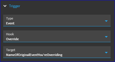

What is your trigger for your copied event? Assuming you’re on the latest version, it should look like the below:
This way your copied event should fire instead of the base event.
You can watch this in debugger to make sure your event is firing and not the base.
