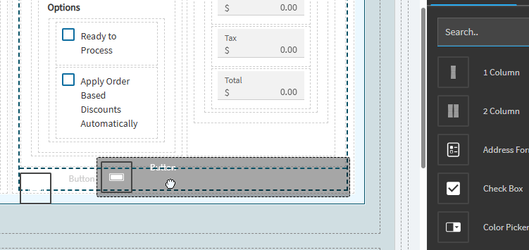

I created a new layer on the quote form and added a couple of components to the main sheet. Did some other stuff, and then decided to start over.
Copied the layer with a Save As, and then deleted the original layer and recreated it. Now, I can’t drop any kind of component anywhere in any layer, even the copy where the two I added still exist.
When I drag the component, Application Studio highlights the container I want to put it in, but when I release the mouse button, it’s as if nothing happened. Poof. Dragging screenshot below.
I’ve logged out, closed windows, etc. I even download the Brave browser to see if I had a cache problem with the browser. It worked just like Edge – dragging, but no dropping.
Any ideas?

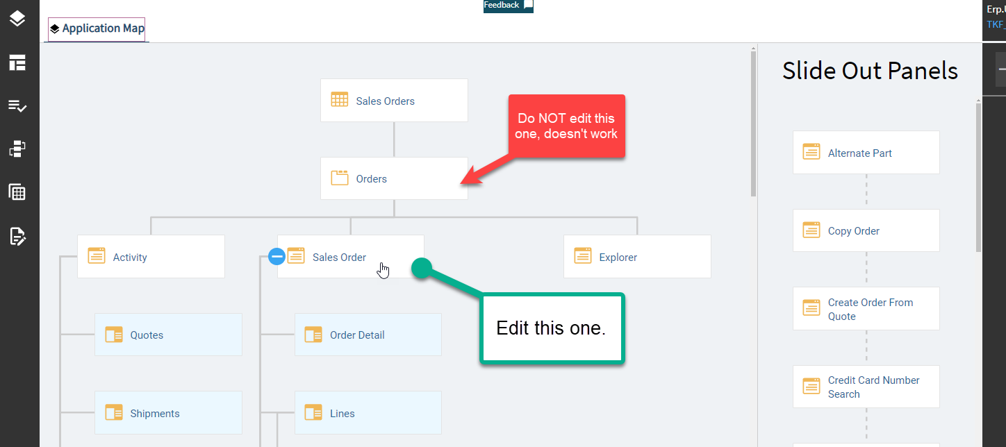

I recently experienced something similar but I was trying to edit the wrong page, check to make sure you are trying to edit in the right place:
This.
GIF by MOODMAN
Many people (including myself) have run into this. The top “Page” just holds the others and you can manipulate the position of the tab pages within it. But to edit the actual content, you need to be editing on the Tab Page (Sales Order).
Well, there’s my “Doh!” moment. I thought I had clicked on that one and gotten only the trash can option.
Thanks, folks!
Joe
