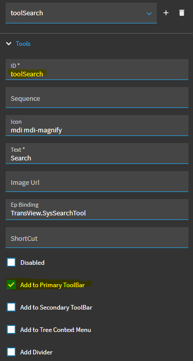

I’ve scrolled through each of my custom layers and all of them have the Search tool assigned to “add to Primary ToolBar”.

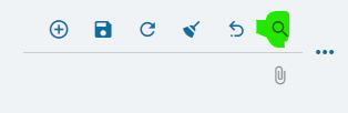

If I preview any of my layers… it’s there:
I’ve even re-published each of my customized layers. However, when I load Part Entry… the search icon won’t appear in the primary toolbar. Its back in the overflow.
Any thoughts on why it would appear in the previews but not in the final published form (w/ layers applied)?
