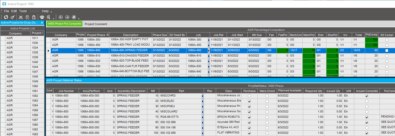

We are currently on E10 and are working on implementing Kinetic. Our Test environment is 2021.2.13. We have made lots of progress on some of the more challenging technical aspects of migrating our customizations to work in a browser-based environment. One thing that I am currently trying to tackle is how to redesign this Classic Dashboard in Kinetic using the App. Studio:
Aside from the layout challenges, I have been finding it very difficult to figure out if there are differences in what can be accomplished in the App Studio for Dashboards versus layers for standard Kinetic screens. Are there limitations to what can be done in App Studio for Dashboard layers?
