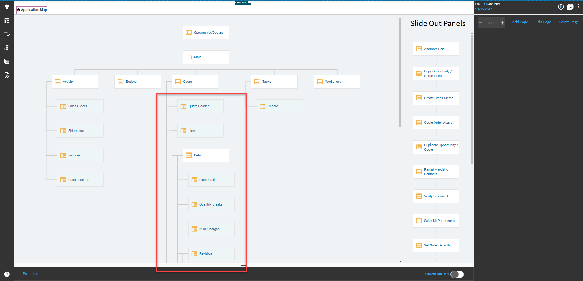

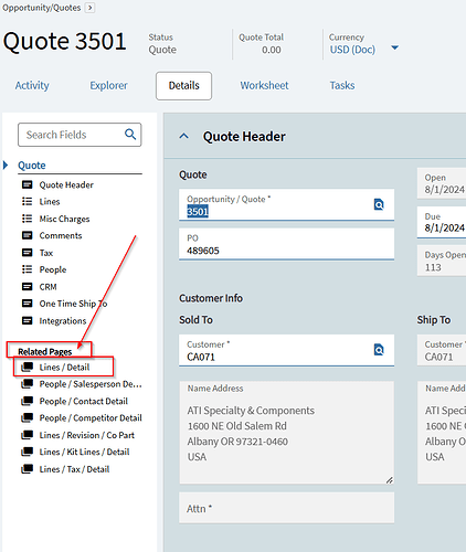

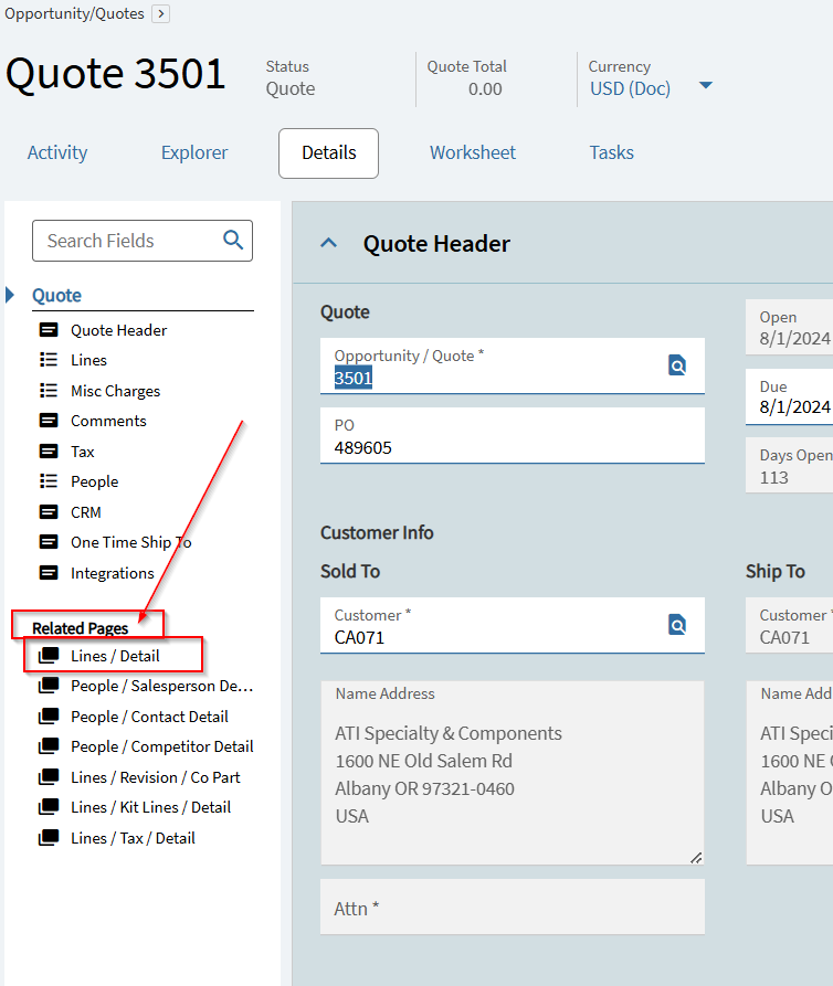

Can anyone tell me where or how in Kinetic Application Studio you get to the “Related Pages” section. Specifically I am trying to modify the Related Pages/ Line Details section.

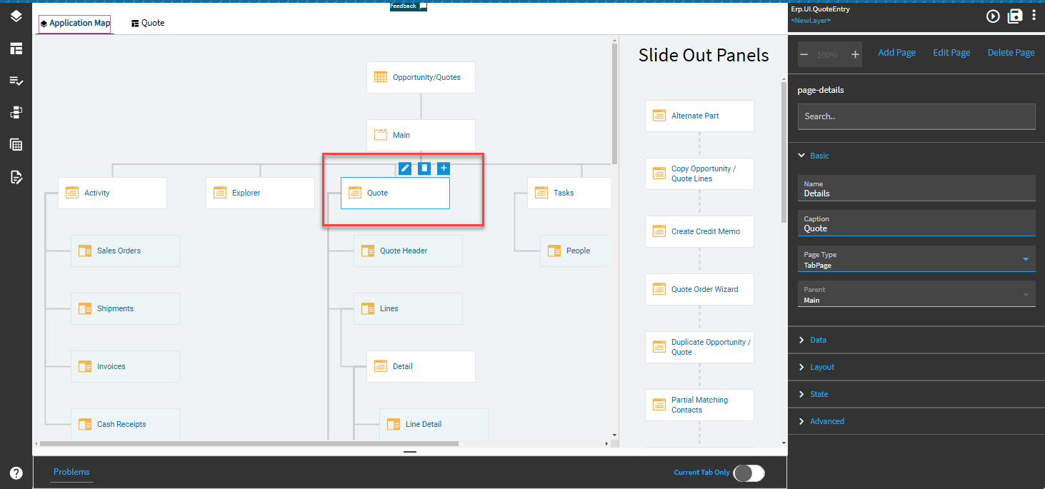

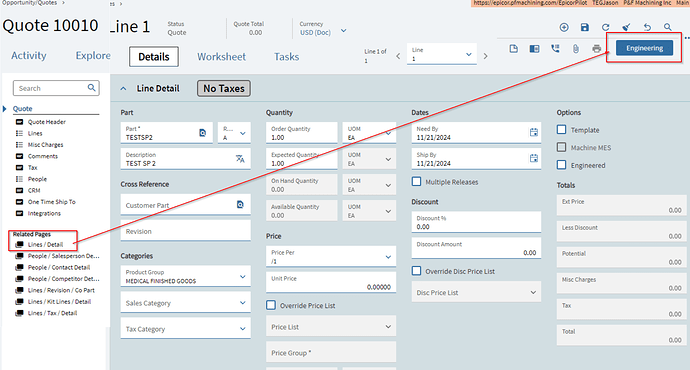

I thought that was the one, but then it appears there is something missing or what I am looking for is in a different place. What I am after is the properties for the Engineering button that shows in the top right hand corner of that Line Detail related page. Its not showing there in App Studio and I could not find it in the Action Data sections. It seems like its buried somewhere I am not looking.
The Engineering button opens a completely different screen called Quote Engineering Entry.
Or are you talking about needing to modify the button itself?

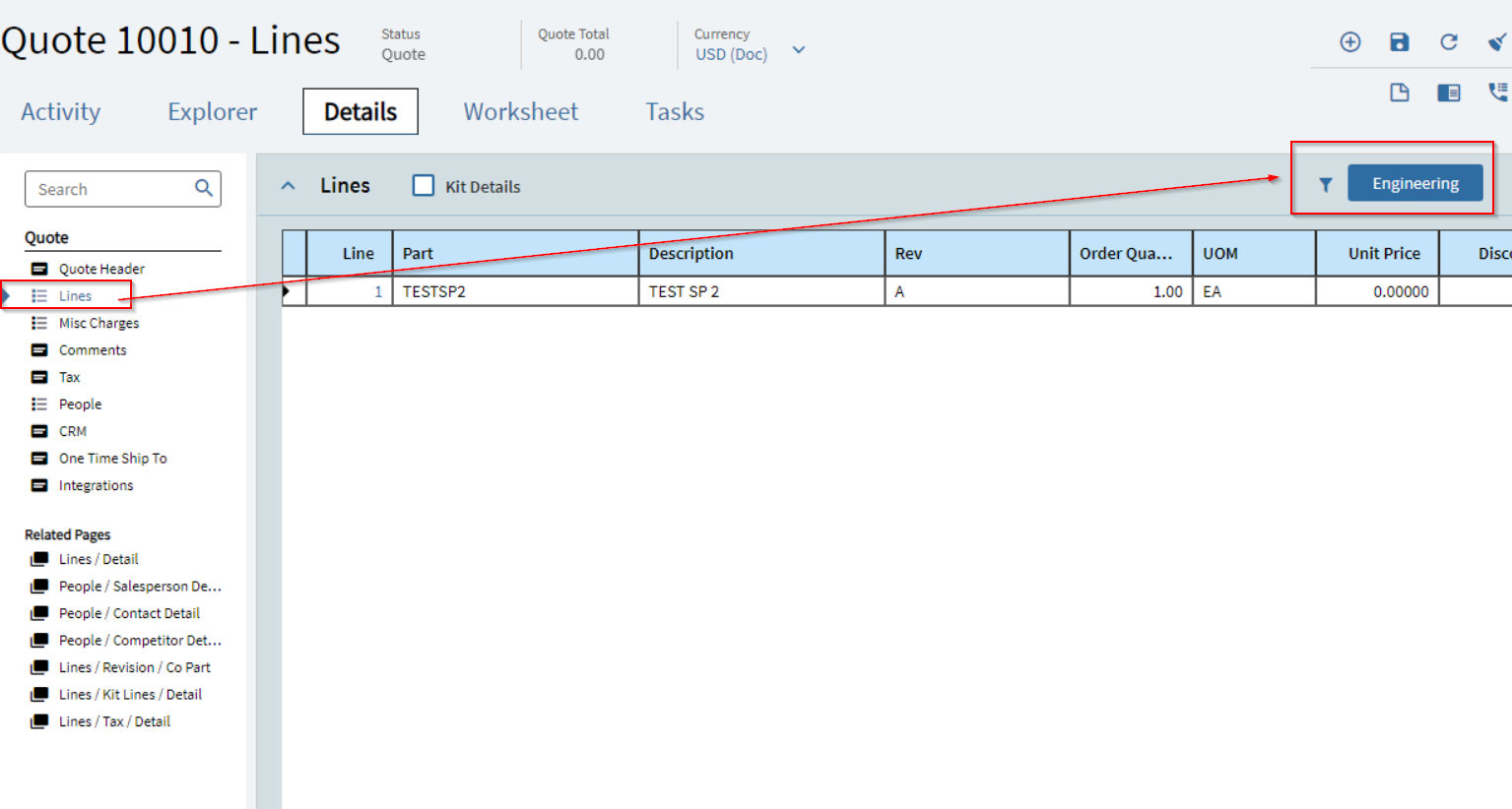

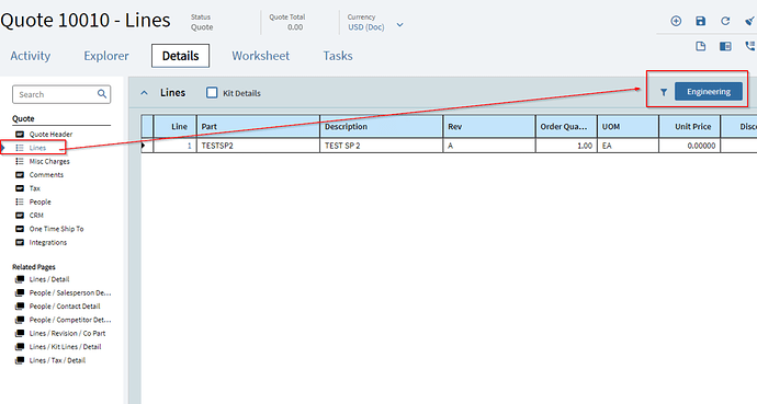

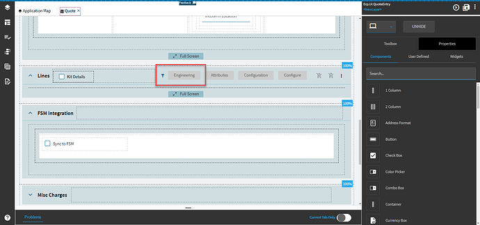

The button is here:

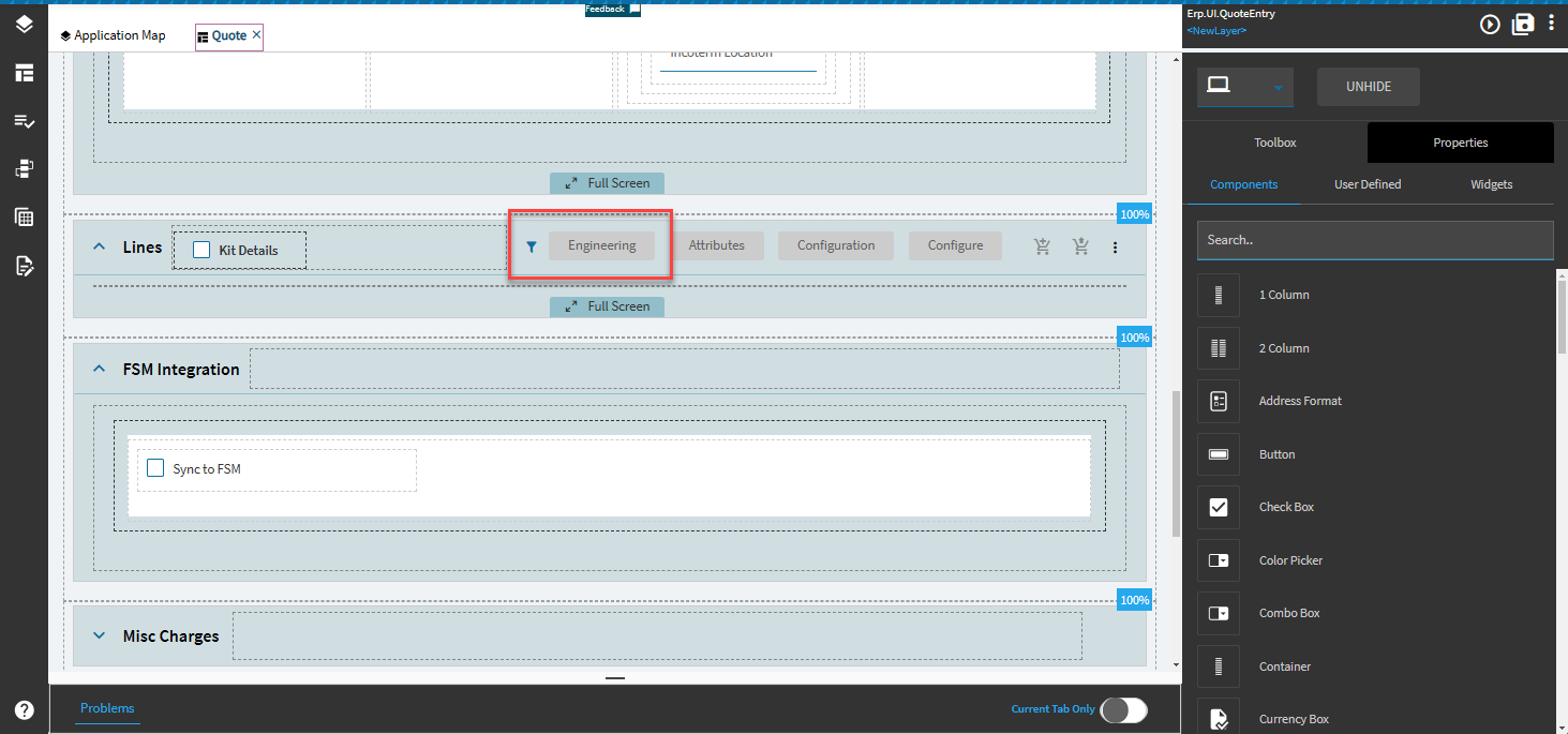

So I was able to identify and modify the event for this Engineering button in this view From Quote/Lines and it launches my custom Quote Engineering form

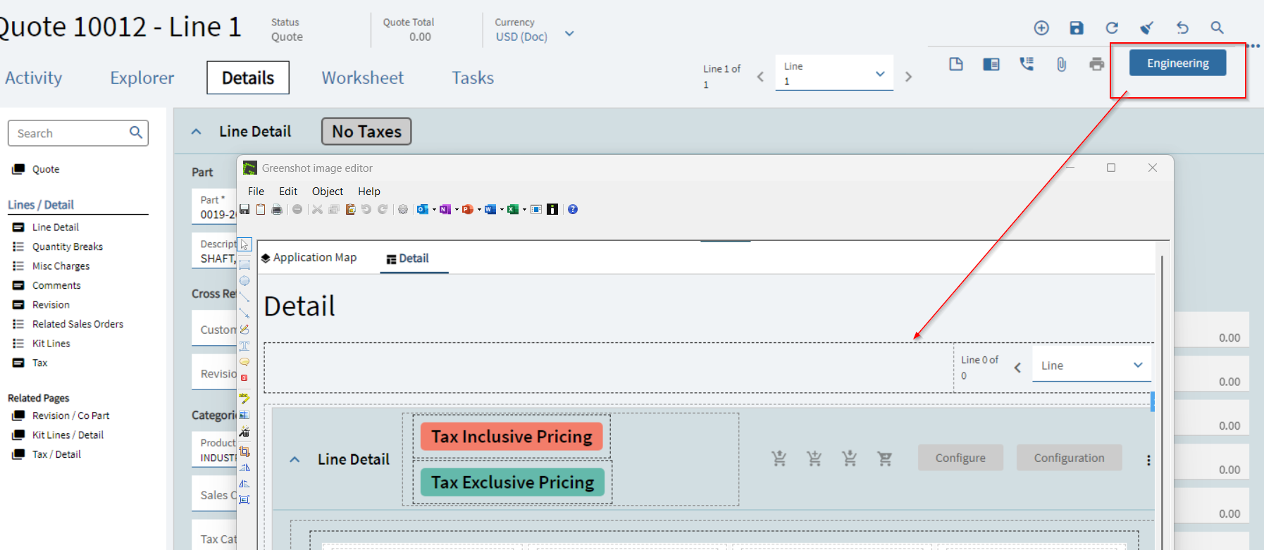

But when I goto the Related Pages/Lines Detail the view changes to this below, and this Engineering button does not launch my custom form like the button does in the other Line view. So I was assuming this was another Engineering button with a different Event tied to it… but I cannot find this one anywhere.
That’s on the Details page.

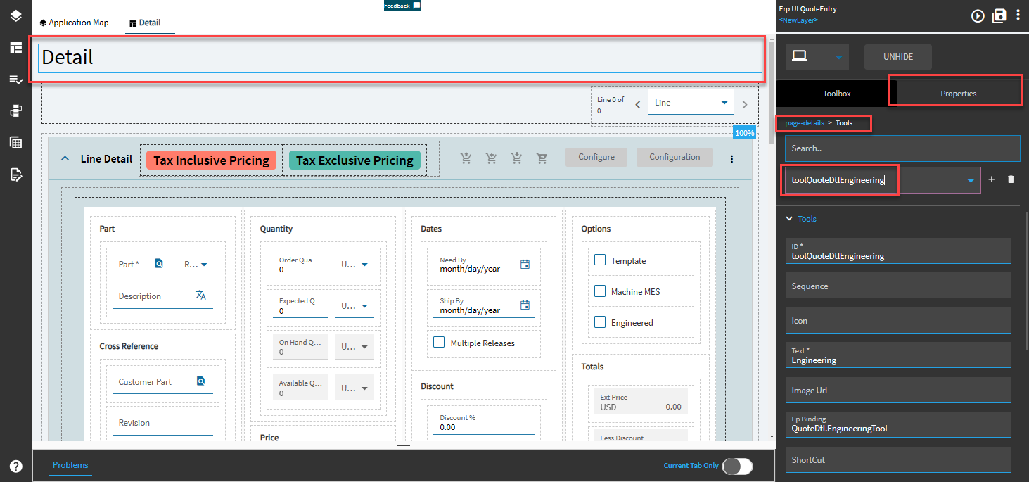

Click the word ‘Details’ at the top, go to its Properties > Advanced > Tools and locate toolQuoteDtlEngineering.
oh SH%@! I would have never figured that out! Got it now. Thanks so much for your help. You rock!
