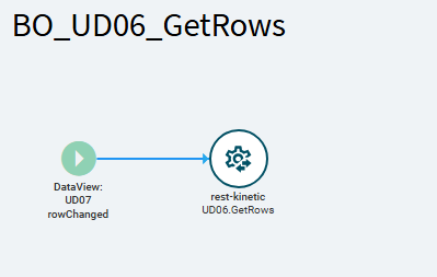

I created a RowChanged event on UD07 so that when the user selects a different UD07 row, the corresponding UD06 data loads.
This works perfectly after the page is already open.

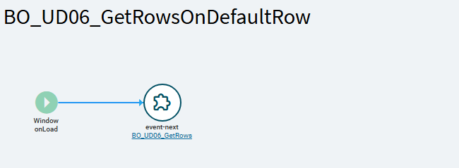

I attempted to use a Window On Load event to manually pull UD06 data during initial load, but this didn’t work.

If executing rowchanged event populates your data correctly, in your onload, call your rowchanged event in an event-next.
Those don’t fire reliably. Use the on create event of some control on your page instead.

This is the event for the rowChanged
Perhaps the trigger is blocking it when the Window OnLoad event fires?

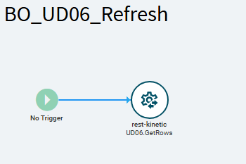

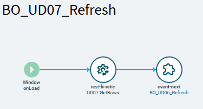

Managed to resolve this by creating a new event to GetsRows on UD06 with no trigger. (BO_UD06_Refresh)
Then used an existing GetRows event for UD07 (BO_UD07_Refresh) and added a next-event to BO_UD06_Refresh, with the Window onLoad trigger.
Now all rows linked to UD07 load on UD06 when the page loads.
