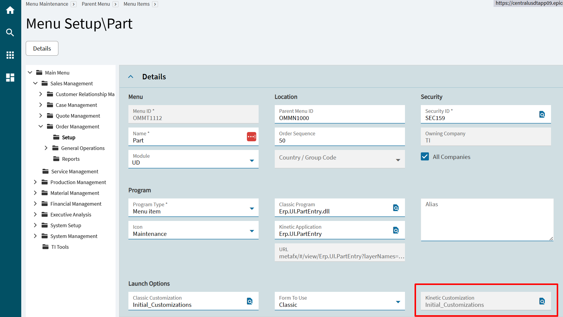

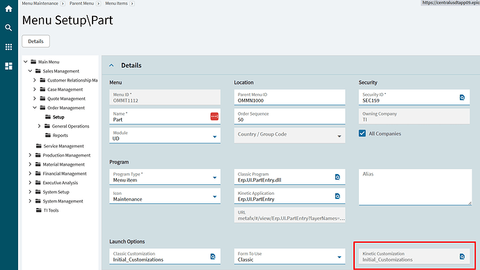

In short, I’ve created a Kinetic Customization for SM → Setup → Part to add some UD fields we’ve had in the Classic client.
I did that and bound the UI customization to the Kinetic Customization setting in Menu Maintenance for the SM → Setup → Part menu item and it works as expected.
However, the app Erp.UI.PartEntry is also accessible from other areas in the menu; namely PM → Setup → Part. And even tho I’ve also set it’s Kinetic Customization value to the same one as I did above, it will not show when accessing the Part Mentenance from this menu tree.

What’s confusing to me is that I am specifying the Kinetic customization to load on the app in Menu Maintenance. Why is it ignoring that setting?
I have the exact same setting on the other Main Menu item that launches Part and it works just fine… :face_with_diagonal_mouth:

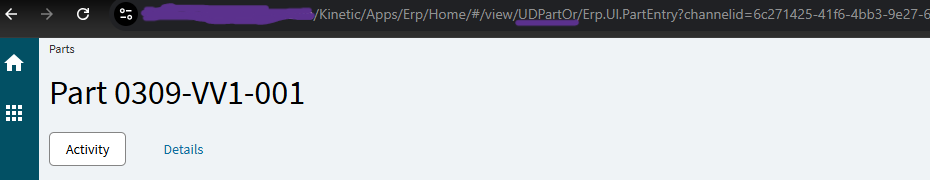

Confirm the right menu ID is being used by checking the URL:
I heard that later versions of Kinetic don’t expose which layers are being used - we are running 2024.2, so we still get to see - in the URL - the names of all layers currently applied to verify that (e.g., layerNames=IncludeSupplierDetails,BOMJobs)
