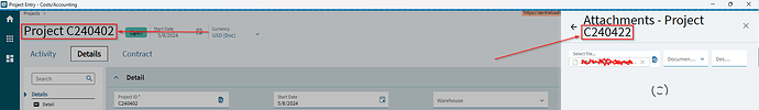

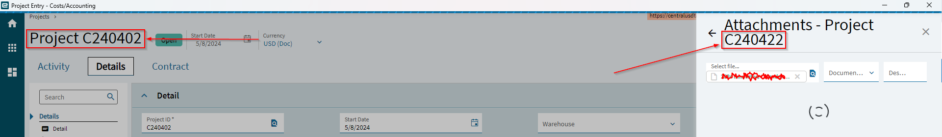

I’ve also started noticing this weird error that occurs randomly. I’ll drag and drop on one project and the slide out will display a different project.
