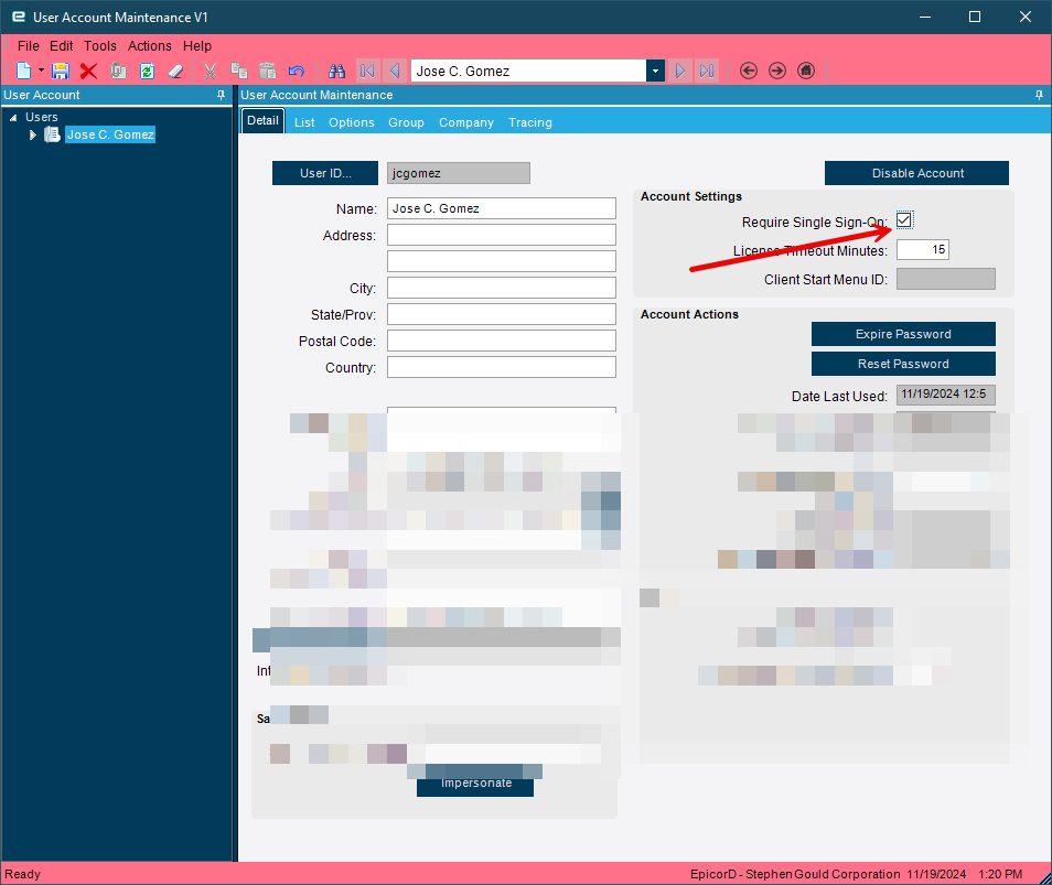

@josecgomez are you saying you can do this same workflow and it will stop you from using basic auth?
If you flag the individual user account as rquire SSO yes.
