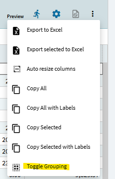

In the Kinetic BAQ Designer, how can I group the data in the analyze table? In Classic you can quickly group and sum in a BAQ. Is that not possible (yet :crossed_fingers: )?
Toggle Grouping in the overflow menu of the results grid:

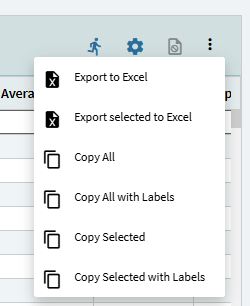

I don’t have grouping either.
Verified Live version: 2025.1.5

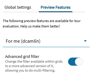

Interesting… try toggling on the Preview Feature (under your user profile) for the Advanced Grid Filters??? maybe it is tied to that??
(I’m also in 2025.1.5)
Thank you sir! That was the thing! I hadn’t looked at preview features. Neat stuff in there!
