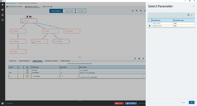

Just received the first copy of Kinetic with our data to test. I am trying to remove a data range from a BAQ by deleting the line yet the BAQ still asks for the date range. I would appreciate it if someone could tell me where to remove the critera so it doesn’t ask for the date range anymore.

Actions, Define parameters. Anything in there will trigger a prompt.
Hello Brandon,
I don’t see the option on my Kinetic screen. (See Below)
I don’t have the actions to select from on the menu.
Thank you.
Miguel
Actions is in the classic screen.
In the kinetic screen, it’s here,
And you delete them with this.
