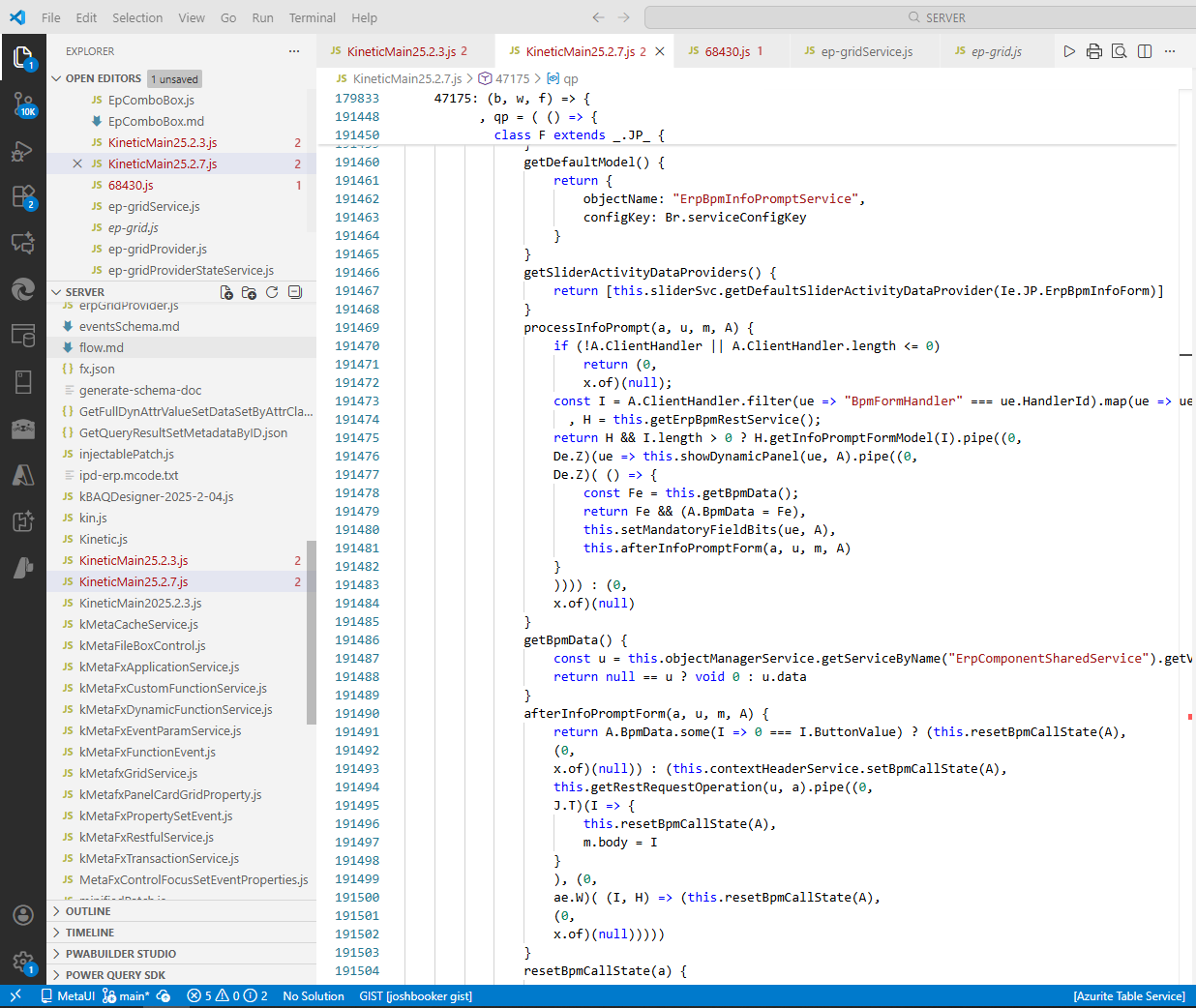

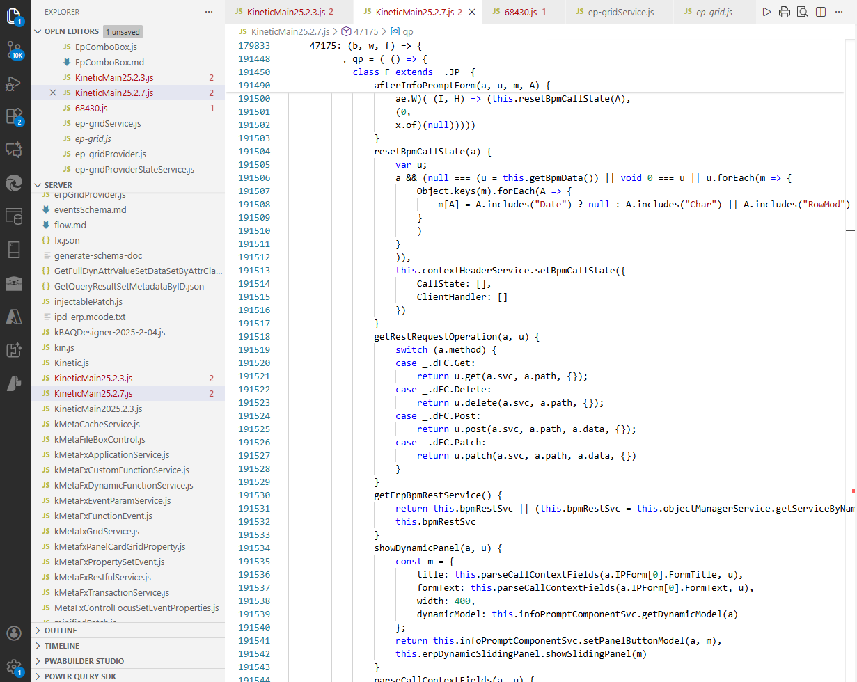

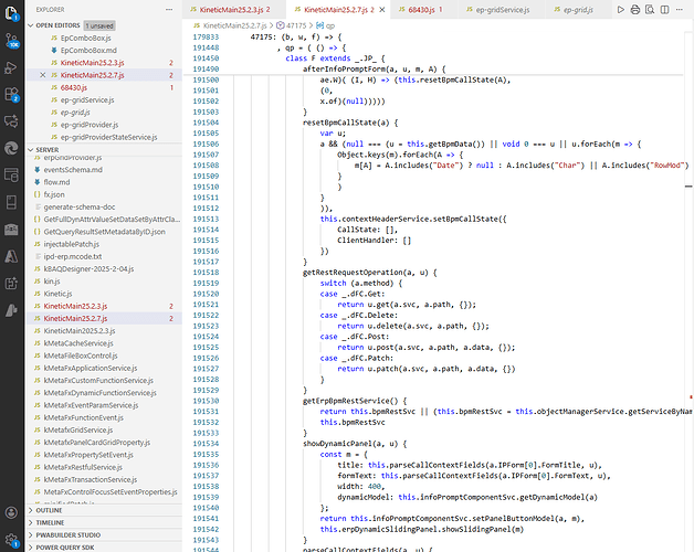

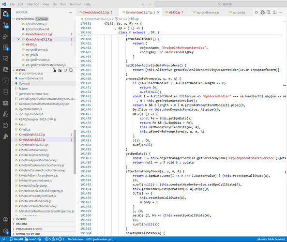

I’ve never done a BPM Form but looks like it’s there in 2025.2.3+ and looks like they are going to use the Dynamic Slider component (introduced in 2025.2.5 - afaik) to display the form:
The bpm data forms have been there in kinetic for years. The problem is that in classic we could customize them. In kinetic we can’t.
Ahhh. I see. bummer. hopefully they’ll do like custom Inspection Results forms and allow a custom slider be defined on InfoPromptForm or something like that.
