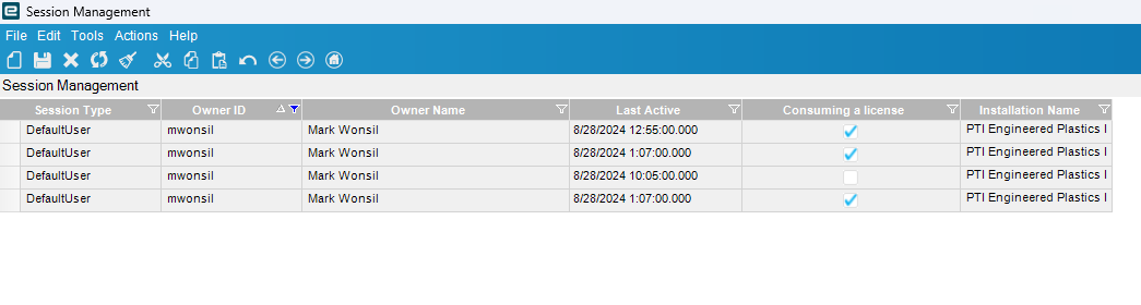

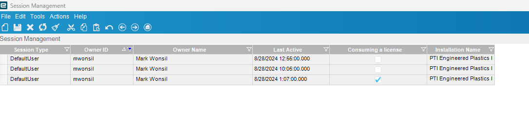

I just did a test. Looked at Session Management and when I added a new instance, a new entry showed up.
When I just exited the client and it appears to have removed the session.

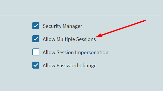

I haven’t had a chance to test, but does anyone already know how the “multiple session” permission applies in this web-browser context?

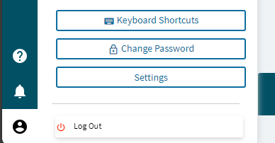

FWIW, if browser users use the log out link:
… Kinetic releases the session and associated license.
