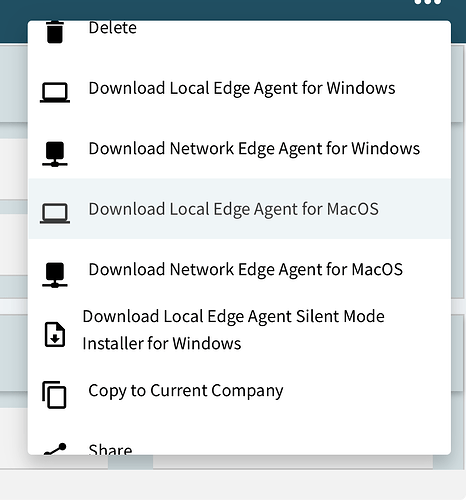

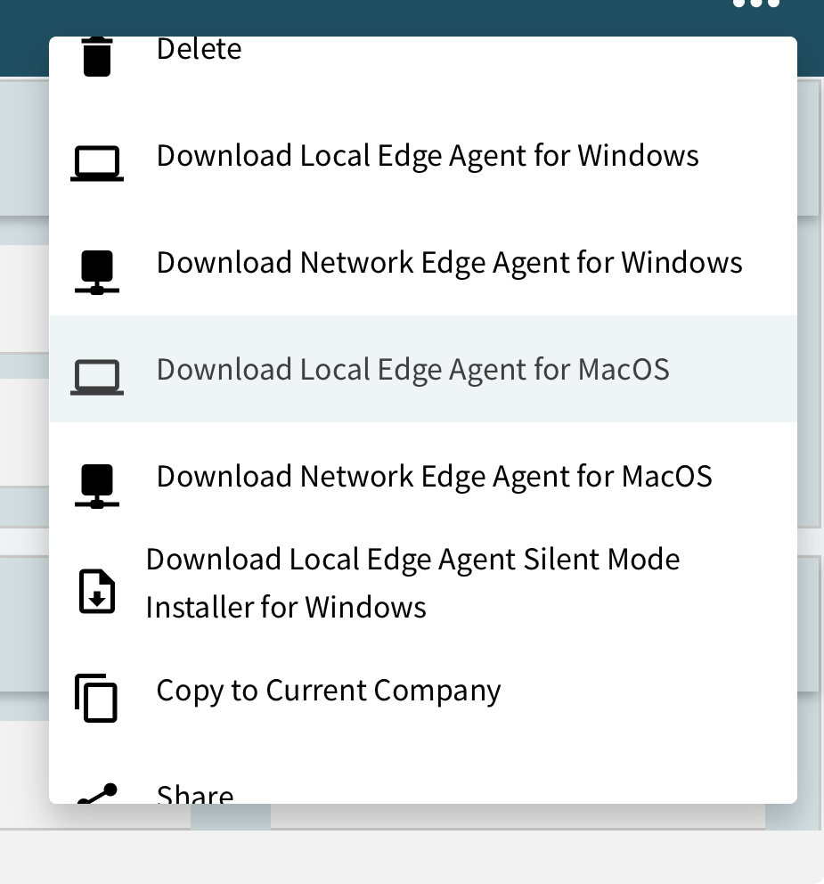

Yes there is :grinning_face:
Edit. Scrap that mind messed with me. There isn’t :persevering_face:. Just windows and MacOS
