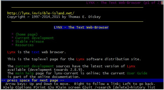

And then there was:
This reminds me of the Gopher Protocol we used to use for browsing Library holdings at Universities… I Don’t remember Lynx, but I remember Mosiac… I’m old, but not ancient yet… give it another decade :slight_smile: !!!

Of course I already tried eww! Lynx will end the same way:
Can confirm though, this forum here is readable in eww. Readonly without javascript, but readable nonetheless.
