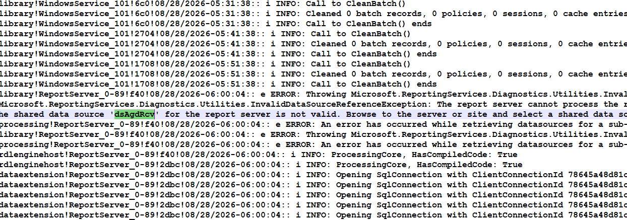

Did I mention you can also view SSRS Logs when your report truly has problems, no not the logs Epicor gives you but actually the whole Rendering process and which fields are suspicious and render times among other things.
C:\Program Files\Microsoft SQL Server Reporting Services\SSRS\LogFiles
You can enable more verbose logging as well.
