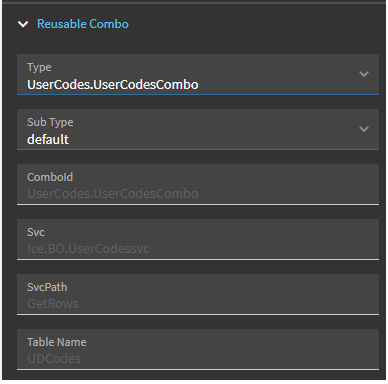

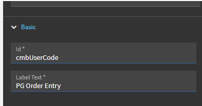

  1. Draw in the Combo in App Studio Like Normal
  2. Set the ID and Name
    3.Go To Reusable Combo
    4.Set the following Fields as follows
    Field Value
    Type UserCodes.UserCodesCombo
    Sub Type default
    FiltersParams CodeTypeParam= (no quotes)
  1. Set the EpiBinding to you View.Field

Jose to the rescue again! Cheers bud!

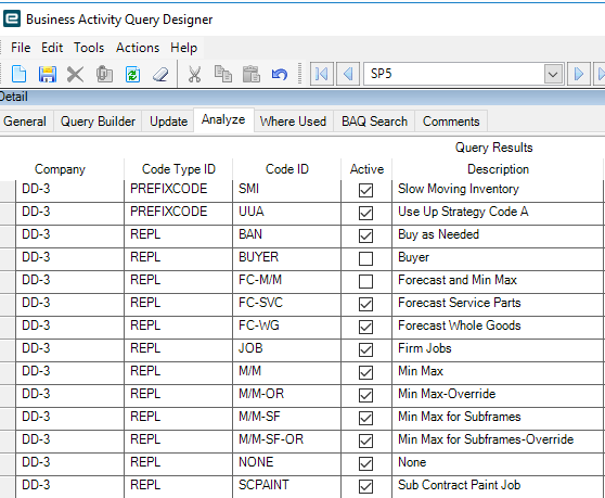

Yes Thanks Jose. I did follow your solution but the combobox returns ALL UD codes, not just the filter…
BAQ as a validation
Any suggestions ???

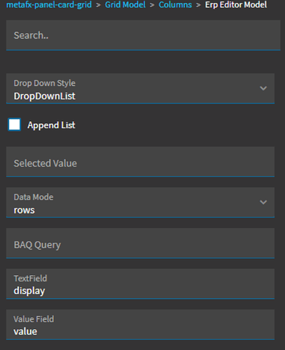

Hi there,

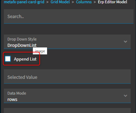

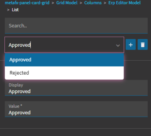

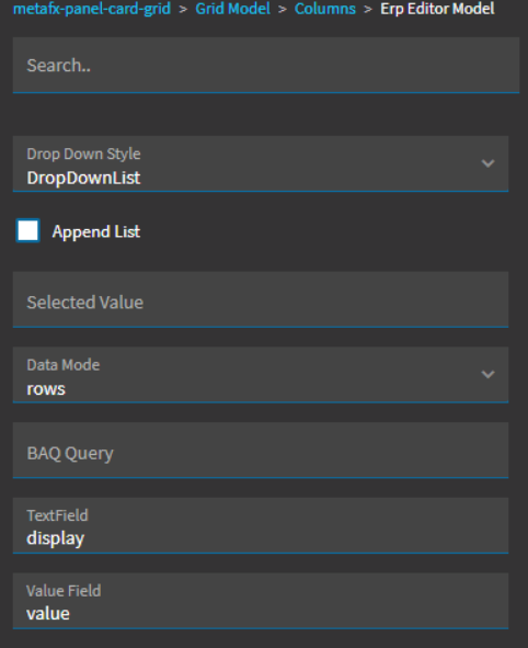

I am also facing a similar issue but on List Combo (hard coded values “Approved” and “Rejected”) in a grid.
Any ideas?
Thanks,
Zoher Ali
Try to check the “Append List” Checkbox
Tried it already.
It still shows a blank list.

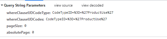

The reason filters append and search filter doesn’t work is because it applies the filter to both where clauses.
It passes a where clause statement for both the UDCodeType table and the UDCodes table. UDCodeType doesn’t have the IsActive field so it fails.
Using a BAQ as a data source will work.

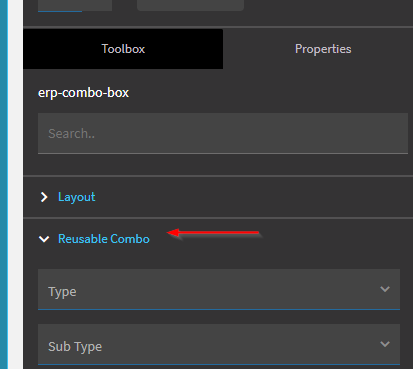

Yes, you can filter only the UDCodes.IsActive = true records.
User Codes:
  1. Go To Reusable Combo
  2. Set Hidden Column Append
  3. Go to Advanced and Set Row Filter
  4. Preview it.
