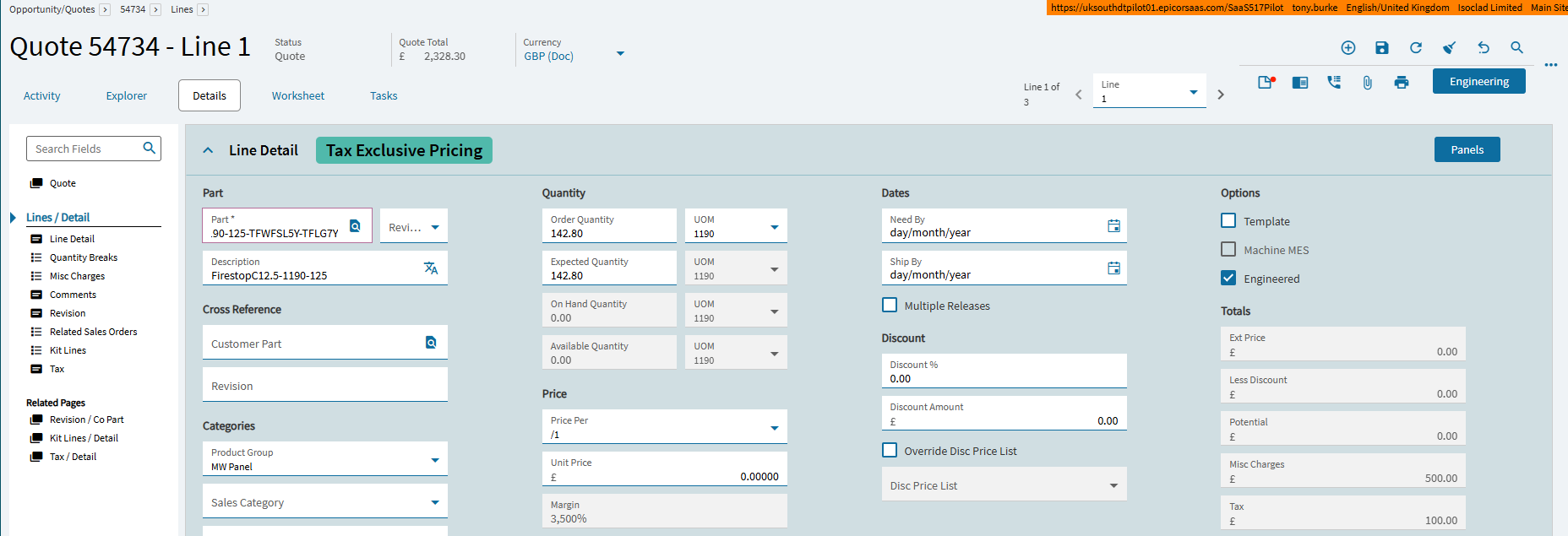

We have re-built all of our configurators in Kinetic and the sales team are now using them, however after some configurations, the configurator button dissapears with no reason as to why…
has anyone else seen this issue? have a missed a checkbox or silly setting somewhere that Epicor love to throw in to the mix! :smiley:
screenshot shows an item that has been configured, but i am not able to re-configure the item. there has been no version changes to the configurator between this being entered and taking these screenshots.

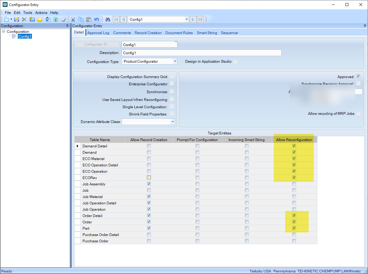

Hi Tony,
Just spitballing, have you checked that you have the allow reconfiguration checked on the target entities (quote detail?) on the associated configurator as desired?
Nancy
Hi Nancy, yes these are checked (and by default i believe) we have not made any changes to these.
and thanks for the suggestion, not one of the areas i thought to check!!!

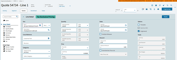

Aren’t configurations tied to revisions? You quoted part doesn’t have a revision selected.
Could be wrong, I’m a little new to CFG stuff.
What are your part number creation settings? As mentioned in another reply the revision dropdown appears to be blank. Which may mean the configurator is unapproved but usually the configurator button is still there. Or the part is not approved. Or the line is no longer considered a configurable part due to part creation setting. Or there is a bug which unfortunately is a common issue with the Kinetic Configurator.
Is the run from the client or the browser, and has the size been changed from small screen to full prior to retrieving the data?
i think this is a system bug, sometimes a revision is displayed other times it is not, and this does not always dictate if the configurator button is visible or not.

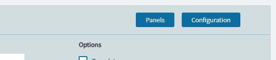

the re-configuration only applies to quotes… heres whats causing the issue

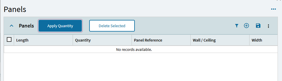

we have a customisation that slides out when we press a button
this is a ubaq that is hooked up to UD01
delete button is self explanatory and simply deletes the selected row(s), the apply quantity button is the little devil causing the issue!

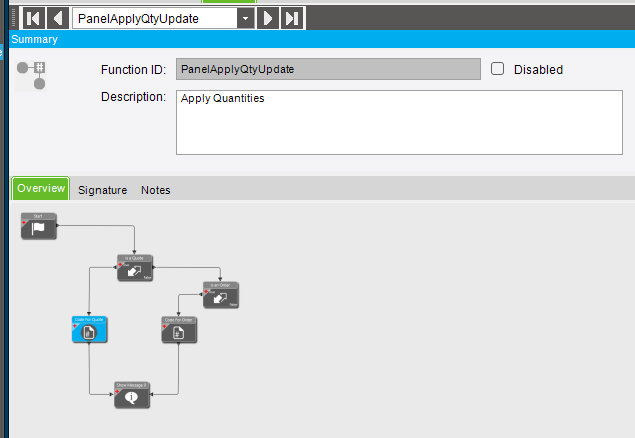

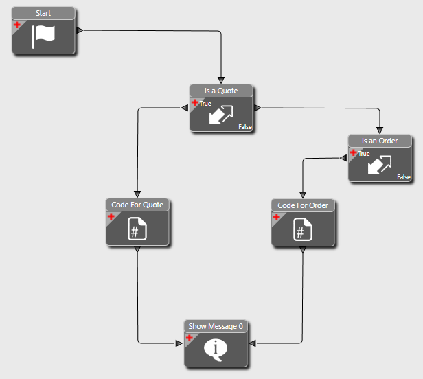

When you press the ‘Apply Quantity’ button, this calls an epicor function
the ‘code for quote’ section is as follows:
