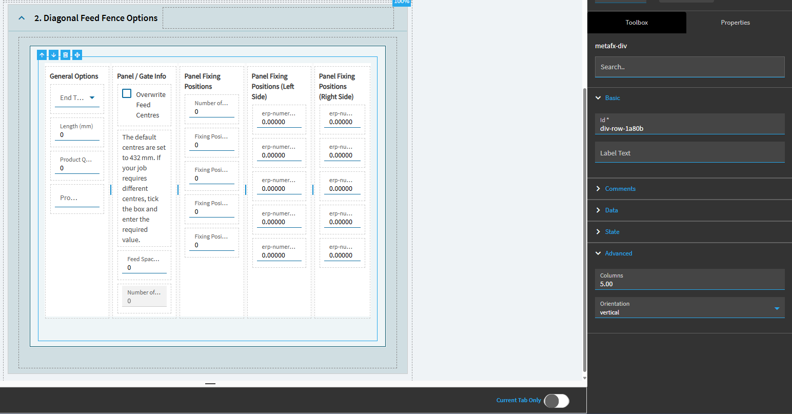

I’m working on a Kinetic Configurator layout in Application Studio and trying to conditionally hide one of the Column controls (the layout item from the toolbox, not a grid column).

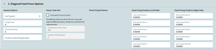

My use case:
  • I have a row with five columns in it. (See screenshot)
  • Based on a user selection, I want to hide one or more of those Columns.
  • I’ve given each column an ID Name and used Data Rules to try and set them to invisible.
But… no luck. They remain visible regardless of the rule.

Hi @aball,
Thanks for replying!

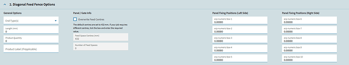

I’ve just tried this and it worked to a degree. It isn’t actually what I wanted though
See screenshot the boxes obviously disappear, but the header remains with the gap. I was hoping for something that would just display the screen with only 4 columns.
But I appreciate the response, might trigger another thought for someone of how we could work this out!

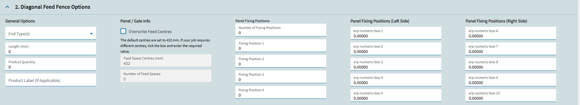

What happens if you delete the header?
If that works, you could change the headers to labels and put them in their own Columns above the inputs. Then hide/show them in coordination with the inputs.
This feels like a Rube Goldberg solution but it might work.
Hi @aball,
It looks better that way I think (No Header, but with label). I think a user would be less inclined to think something just hasn’t loaded yet.
It’s not exactly what I wanted as the label isn’t as clear as the header but it’ll do for now. I might put an idea suggestion on though so we could hide a column feels like that would be quite a useful thing…
