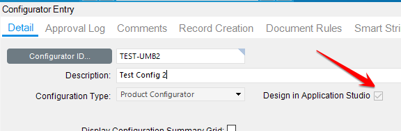

How does the setup for Type 1 differ from Type 4? What is the conversion checkbox? Is the “Design in Application Tool” checkbox? If so, I think we have strong nominee for the new worst button to check since “Sync Dataset”.

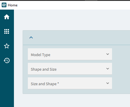

Once checked, my configurator layout opened from Actions > Configurator, Designer, but I didn’t appear to be able to edit the controls at all. Also can’t edit the controls in the traditional designer, or uncheck the application tool checkbox. Essentially bricking my configurator. This is all test, so no big deal. Just trying to figure out the learning curve.
