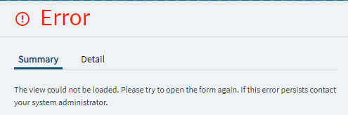

Kinetic custom app "view could not be loaded" in client/MS Edge, but not Chrome
While investigating why one of my converted custom dashboards is not returning any data in the application (browser login) when it does in the BAQ designer, I came across a bewildering error.
I decided to open the particular dashboard I was troubleshooting in the client, I got an error stating “The view could not be loaded.” I wasn’t getting that error in Chrome. Was trying to debug with developer tools in Chrome comparing this dashboard to another that works correctly, but wasn’t seeing anything helpful. So I decided to use Edge and follow instructions I’ve found here on how to use browser developer tools to debug. I first opened my good dashboard, but it also gave me the same error in the Edge browser, but it did not in the Chrome browser. So I tried my troubled dashboard in Edge and also got the same error.

I didn’t, but it worked fine in my Production servers until today after I made an update to the dashboard last night. Now getting this error again and when I check my server logs I see the message: “Ice.BLException: Missing MenuID in EpMetaFxRequest”

I ran into this problem using a brand new Kinetic dashboard, not even a converted dashboard. There’s nothing in the dashboard other than displaying a BAQ with grid.
I created a new layer with no changes, and saved it. Applying the layer in the Kinetic Customization field of Menu Maintenance caused the app to start working.
I was running into this on 2024.2.10 for a UD form. The error only comes up for me on the web version, including in App Studio. No indication as to what caused this, as the UD form is new so there haven’t been changes. Other unused UD forms open just fine.
Adding a new layer from installed client let finally let me open it. Not sure what changed as I had tried this previously as well as publishing a version. Found this thread and decided to try again.
