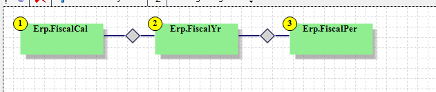

Hello, I’ve created a dashboard application which contains a main grid whose source is a BAQ. For this grid, I have set up two filters (in grid view options), one of which shows the following columns from the specified tables:

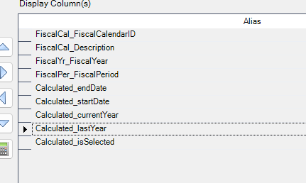

The formula of the calculated fields is as follows:
(convert(nvarchar, FiscalPer.EndDate, 101)) as [Calculated_endDate],
(convert(nvarchar, FiscalPer.StartDate, 101)) as [Calculated_startDate],
(Constants.Year) as [Calculated_currentYear],
(Constants.Year - 1) as [Calculated_lastYear],
(0) as [Calculated_isSelected]
