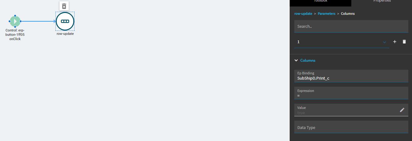

The box is still not getting checked once i set up the event…is there something else i am missing.
Try removing the “=” sign in Expression.
You should just need the value of true (or “true”)
It is true that the setter (=) is implied in a row-update widget … but that’s not the Update I was talking about - it should be a call to update your data (save changes)
row-update is for updating the data in data views on the client side (which is already done when you check the box)
Is this a updatable dashboard like @klincecum was suggesting? how do you trigger that update - or what’s the BO method to call to make it do the update? can you set it to update onRowChange?
This is not an updateable dashboard. The print button that checks the hidden box is on the subcontractor shipment entry screen. I would like it to update onClick of the print button and save all in the same event. I can then use a row rule to clear the check box.
Assuming the subcontractor data is already a data loaded view with a valid save event in that dashboard and not custom made:
You would go to the Behavior of the button and into the onClick event, then you would do the following widgets more or less.
widget 1:
row-update (set the Parameters → Columns → Ep Binding to your desired Table.FieldID and then value to “true” with quotes) → on success →
widget 2:
event-next (set Event ID to the screen’s base Save event for that dataview. Can usually find this by going to the page and to the action on the grid and see what it calls, or just browse through the list of events if the screen is small enough)
Then a few options, but I’d recommend unsetting the flag in the BPM that prints and refresh the dataview
widget 3:
event-next (calling the refresh event for the page so you don’t get a weird row modified by another user issue and so it pulls in that you cleared the flag in the bpm)
row-update alone does not save the view. It only changes the data loaded in the view in the screen in runtime. Remember javascript is a runtime language so we have a lot of flexibility in the screens. All the changes we make to the view is only an object in runtime and not pointing back to the db directly. To save it back to the db, you have to run the save event of the screen the same way we used to use reflection in c# to do. Or I believe you can probably flag it dirty if the underlying view is set up for that in the views section but I haven’t played around with that myself.
