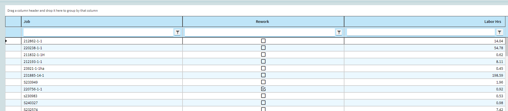

I have a dashboard that I converted to Kinetic, it is pretty simple.

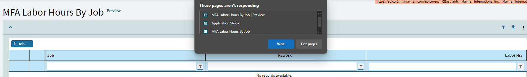

I want to group by Job, but as soon as I drag the column up to the group by box, the dashboard seems to hang and take forever to refresh itself.
Is there something that I am missing or is this another bug that has not been fixed?

Example we are able to recreate: DB that has physical inventory, grouped by Warehouse, then Bin. Our largest Bin takes 13 seconds to expand in the best circumstances, up to 60 seconds on a terminal server that has shared resources and lower internet speeds. For those on the terminal server it will timeout and kill their entire Edge session until it catches up. Same DB on an iPad? Everything loads. Not like that tells us much, but there may be certain users that can use that until the actual issue gets resolved.
Thanks for the tip, we’re not currently using any mobile screens but I’ll test on my end and see if its something we use can use in the future. We’re also in the process of converting to kinetic and have a few more complex queries that are fine in Classic, but noticeably slower in Kinetic. And trying to group or ungroup causes the browser to crash. Same results in Chrome and Edge. Thanks again for the insight, much appreciated.
