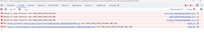

I transformed a classic dashboard into a kinetic one by hand. One of our users gets the dreaded white page the first time she opens the dashboard in the client after a PC restart. 2nd time loads fine. We enabled devtools, and it’s showing an ‘ERR_CACHE_READ_FAILURE’.
Any suggestions on how to get it to work properly the first time?

Ah, we also have a user using the desktop application that has this same problem - they are on a very old machine and usually have many epi tabs open simultaneously.
My thoughts are the computer hardware are at fault but unsure.
Our user is on Win11 with 16GB ram and an SSD. She sees the white blank window even if it’s the first app that’s opened.
I’m on an old Win10 machine with no issues.
