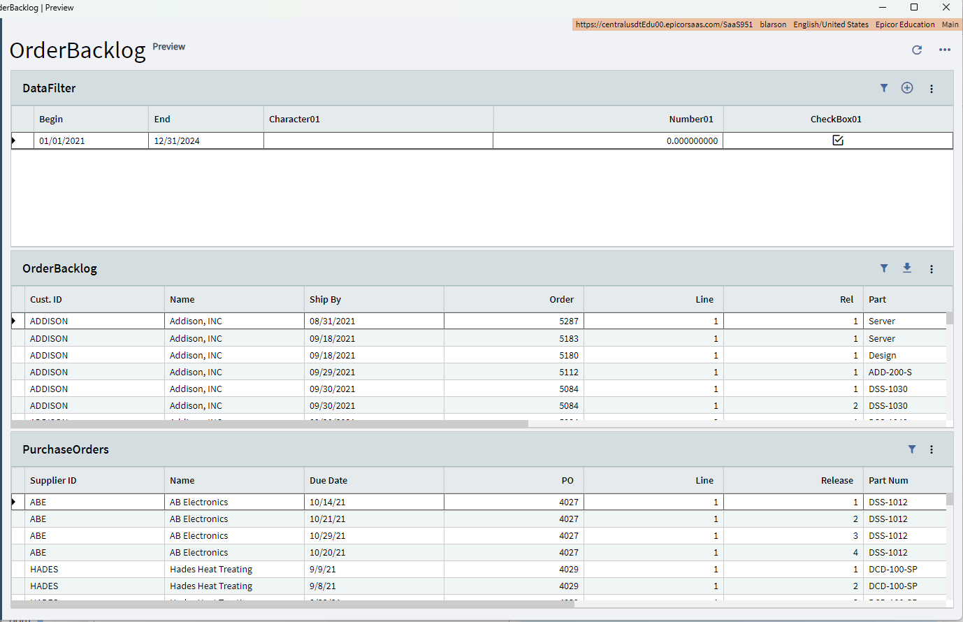

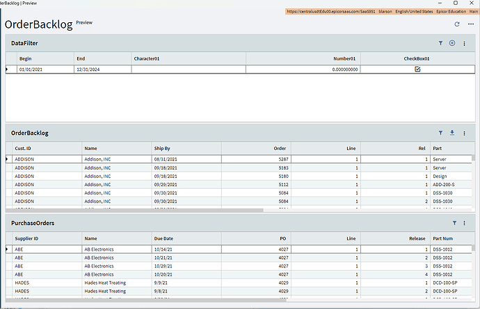

Here’s a dashboard to demonstrate how you can capture parameters and feed to multiple BAQs
Grant why would you have a dashboard showing Order Backlog along with Open Purchase Orders?
UsingUD11ForParameters.dbd (291.2 KB)
    1. First Time you launch dashboard - you need to add a record to the UD11 linked to your userID
  1. After you put in the date fields update UD11
  2. Refresh all
