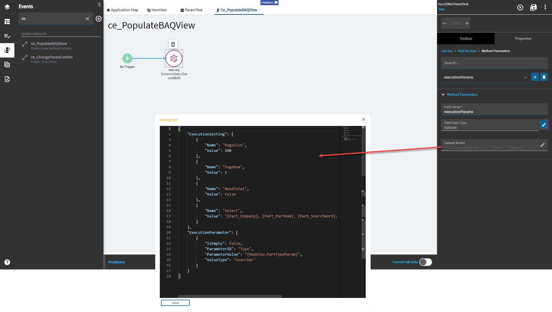

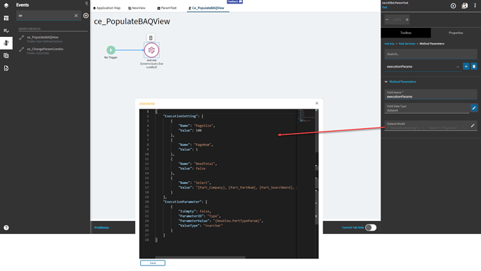

Here’s the setup:

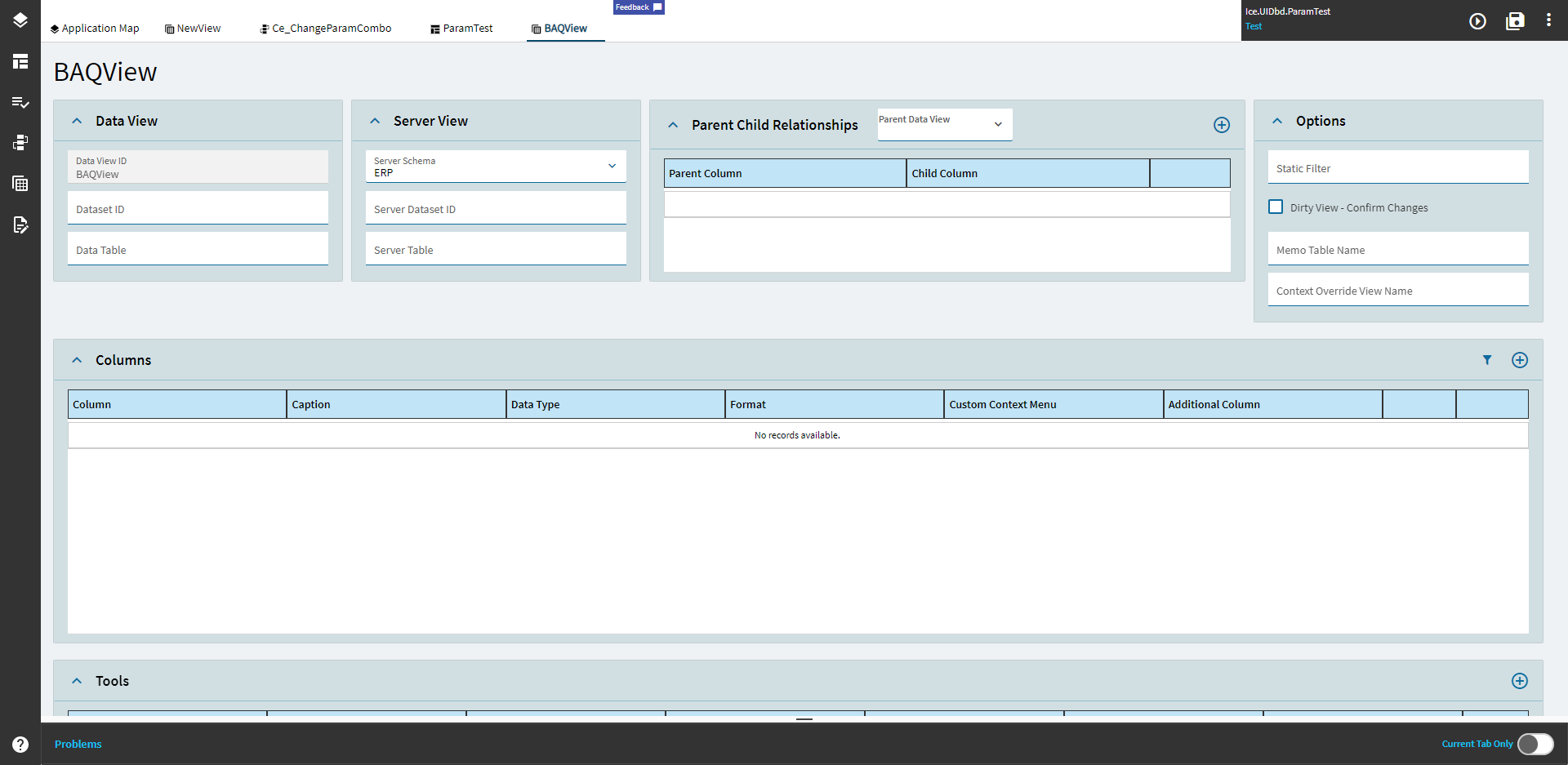

Make a placeholder view. Don’t make it an actual BAQ view or it will pull the params slide out.

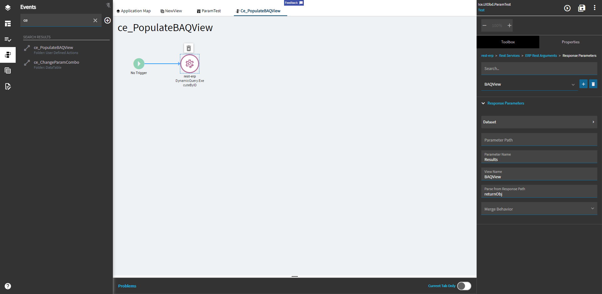

Remove all bindings on the native grid and add your own reference to the new view you made (BAQView in my instance).

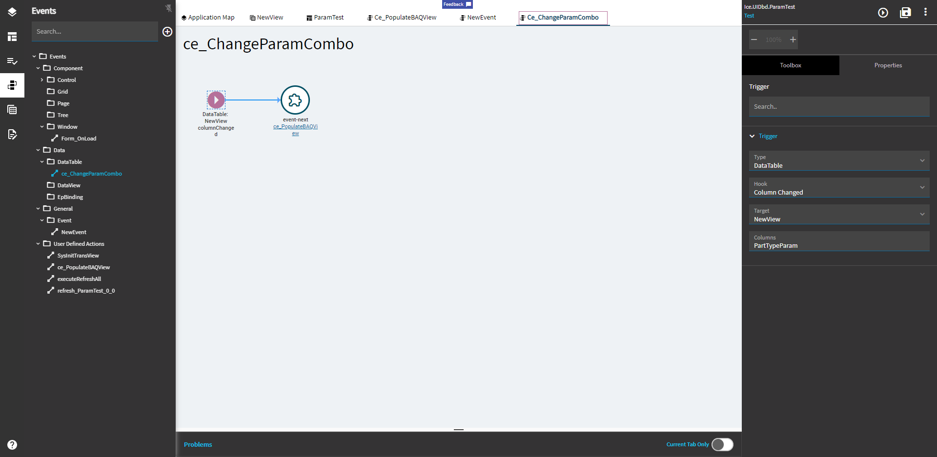

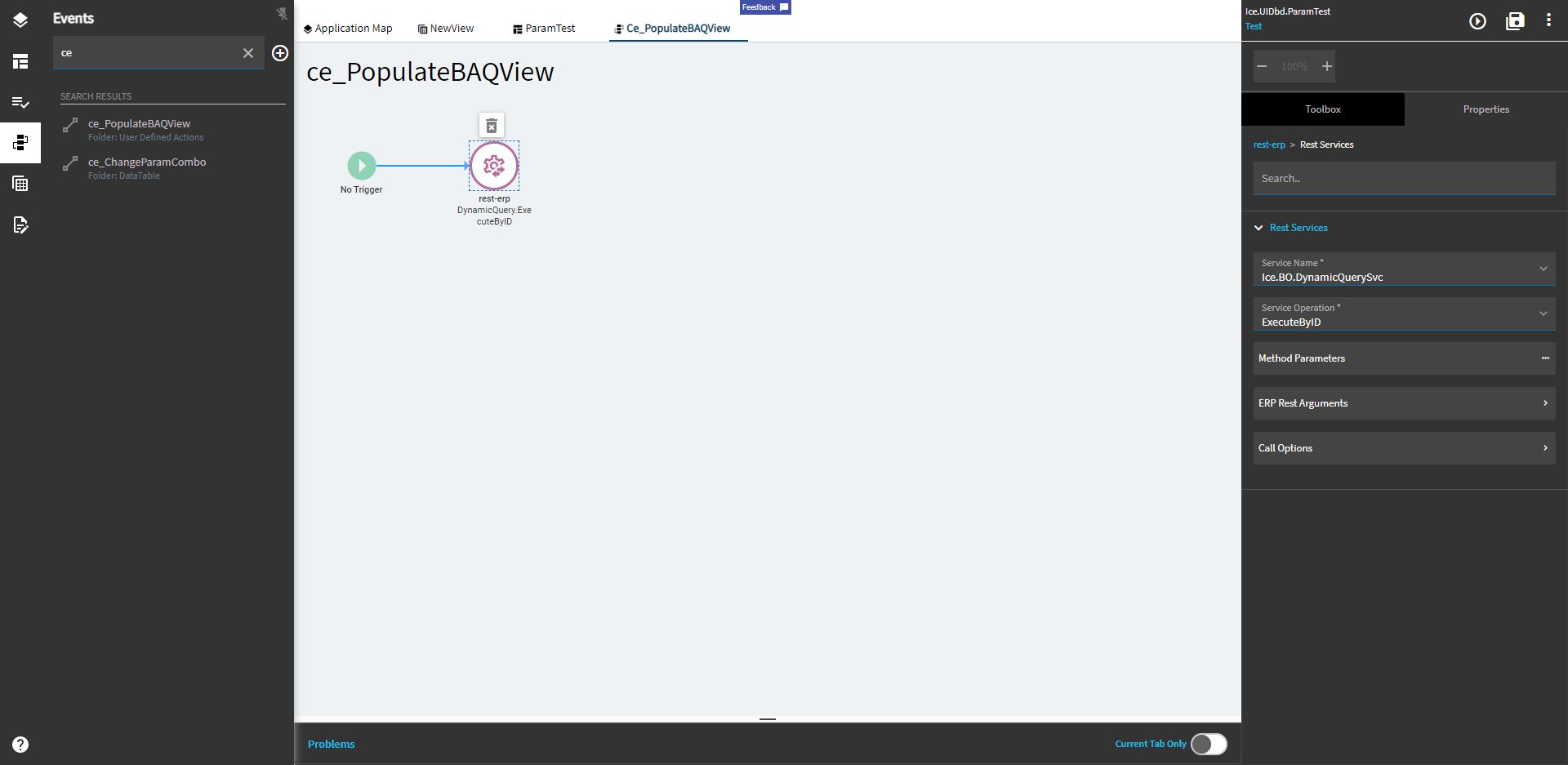

Create an event to populate that view:

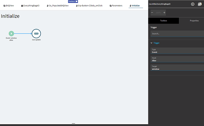

I made my parameter a dropdown on the front page. Bind that to something and after the form loads, initialize it for the first call. I guess, strictly speaking, you probably don’t have to initialize it?

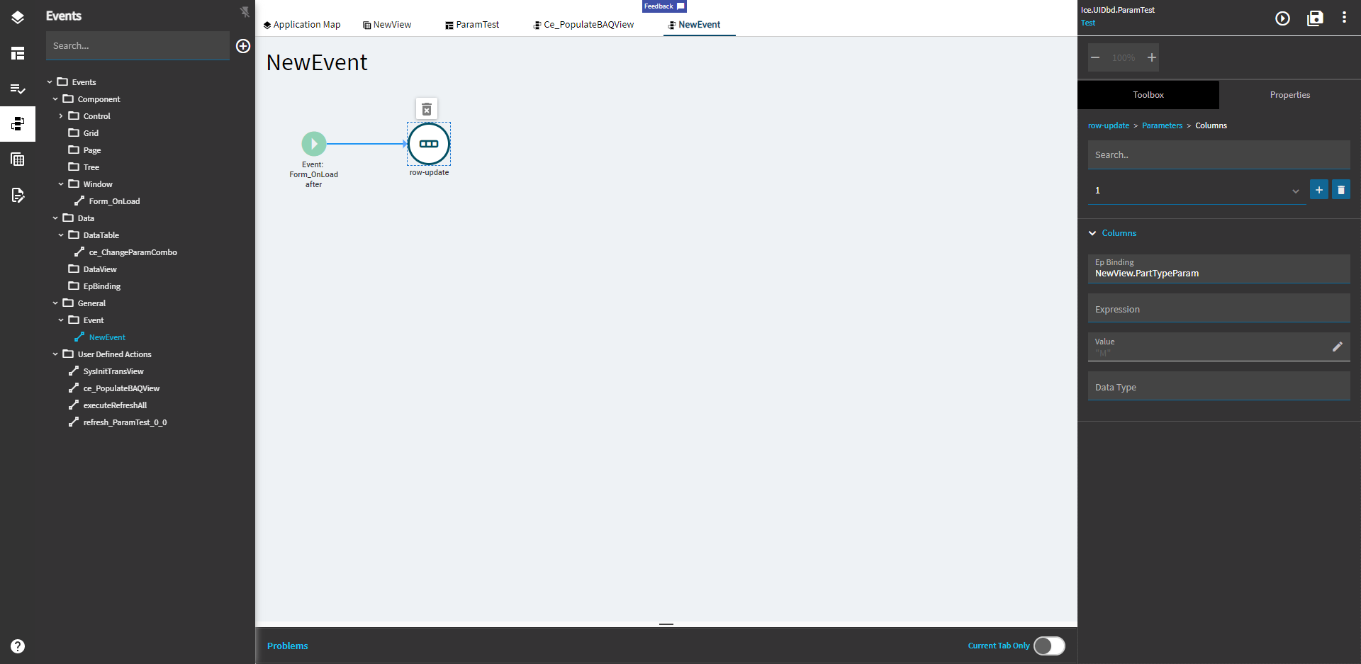

Create an event that fires on change of your parameter field.
ParamWorkaround
#CloseEnough lol

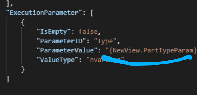

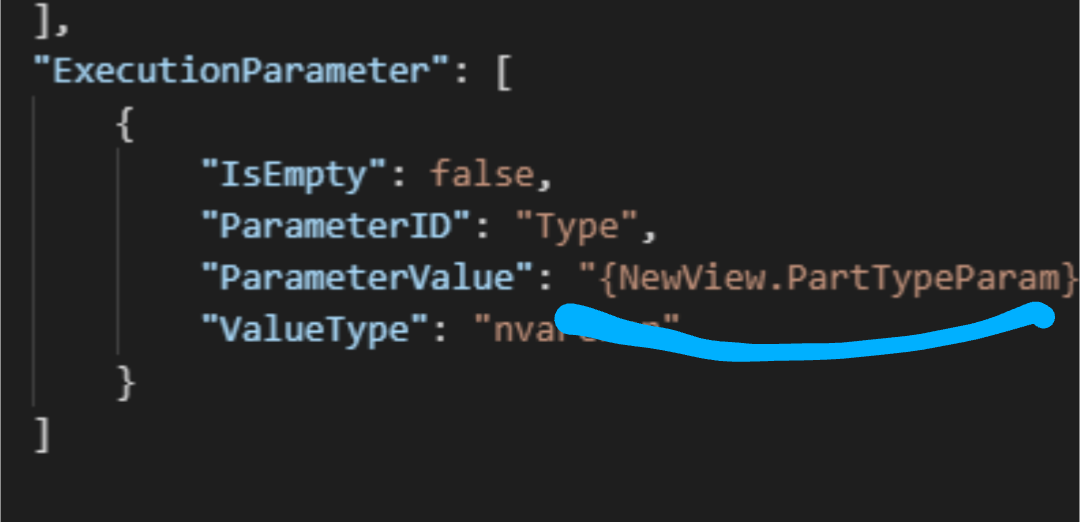

OMG Thank you this works really well, I just set my page size to 100,000 not sure if this will cause any issues. The query explodes all BoMs for a customer or product category, so it can be pretty hefty.

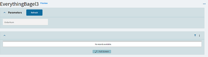

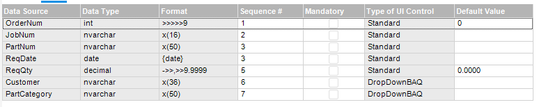

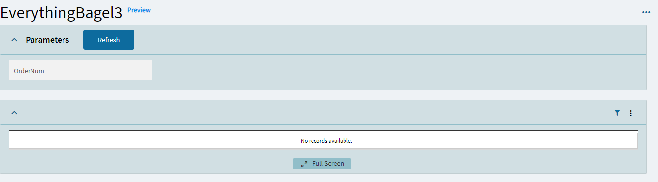

I have it working just statically right now plugging in a string in the executions parameters. I am a bit confused on how to get it to bind with my textbox.

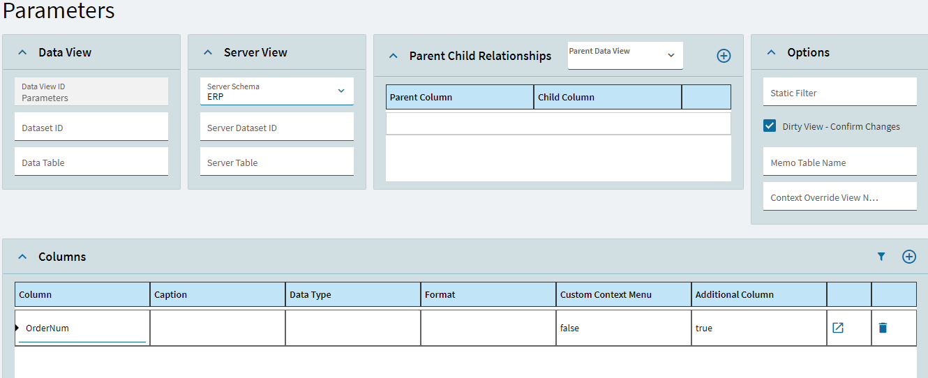

These are all the parameters the BAQ has(Currently just using a textbox for Ordernum just for testing):
mother of god danger GIF
Just change this out for each parameter based on what your textbox is bound to.

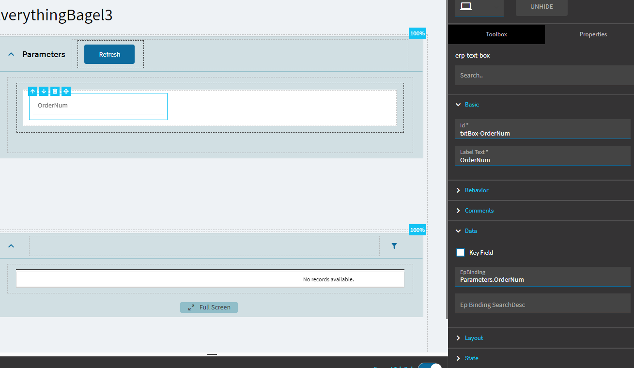

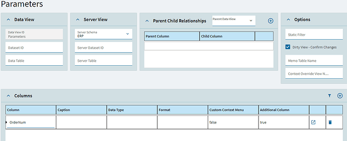

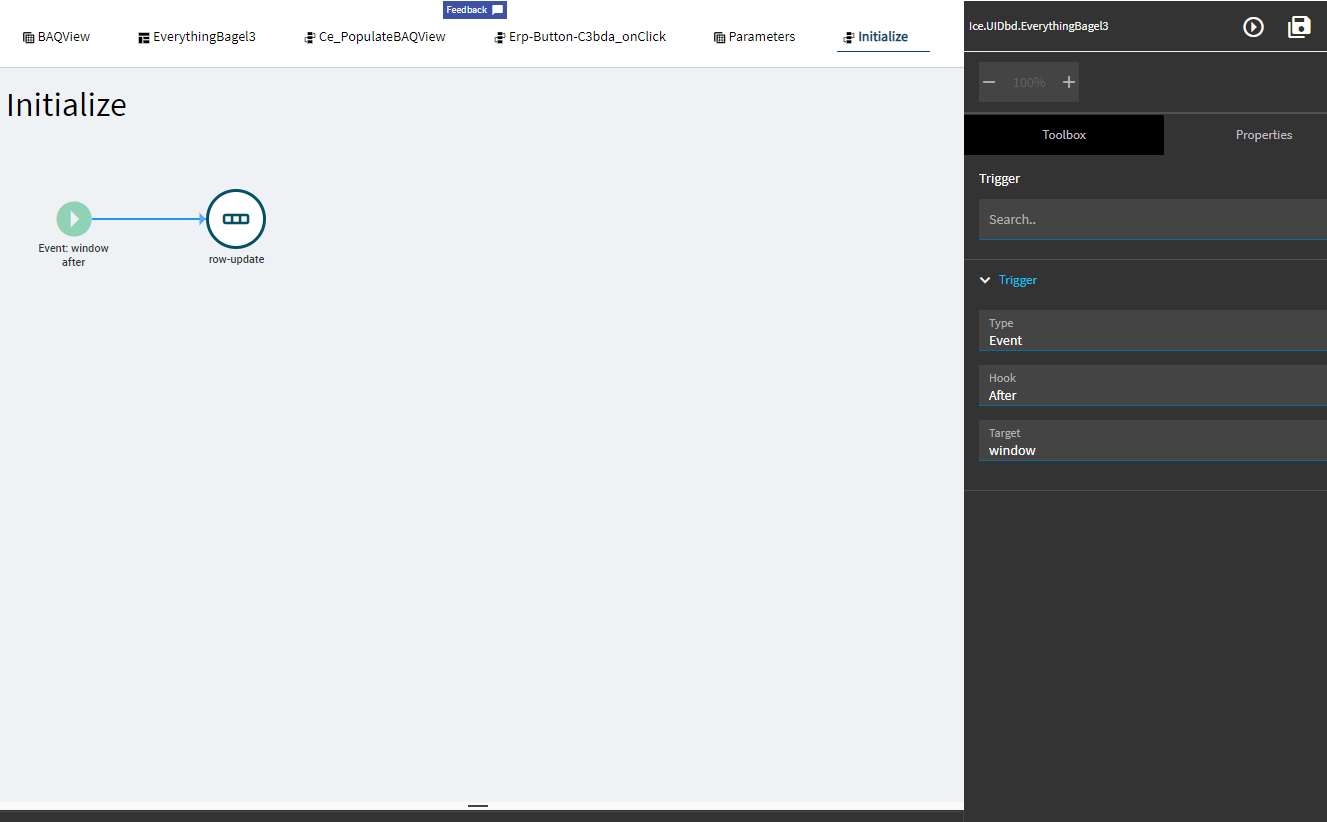

So I made a dataview for my parameter, and bound the textbox to it, but now it is coming up grey and I cant enter anything.
I might have forgotten the initialize bit. After form load, use row-update to set it to “” (empty string).
Took a bit of digging to get it right… Not sure if it is just a matter that I am in Cloud Kinetic, but Form_Onload is just window
