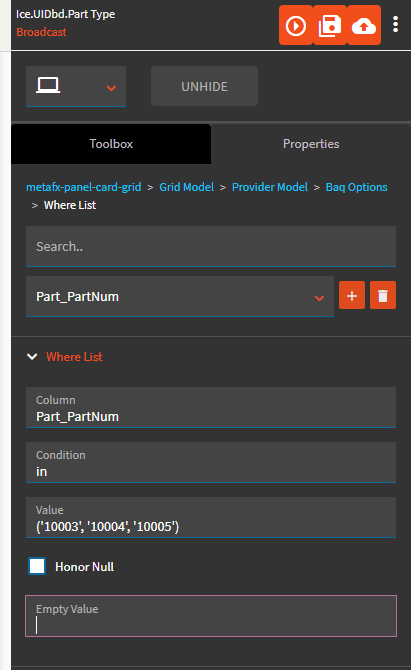

You can then set the BAQ where clause to use the “in” operator and set it to that field.
Visual with hard-coded values:

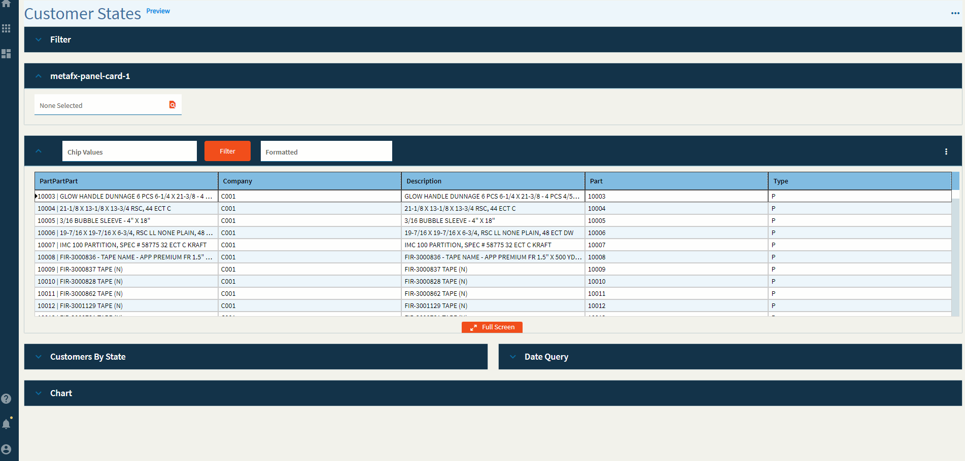

That was actually kinda fun to set up.
FiltersAndChips
I used a button click instead of an AfterFieldChanged event, so I can see and control what was happening while debugging; you can easily have that all happen after clicking OK from the search.

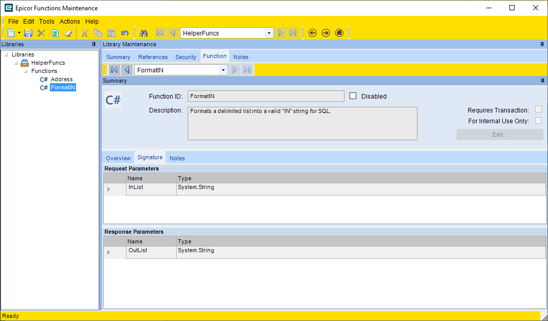

The BAQ in the grid’s provider model has a “WhereList” item set up that’s looking for the value in the “Formatted” text box.
When the button is clicked, it calls a function that takes a tilde delimited list (Chip values) and returns it as a valid SQL “IN” value as you see in the Formatted box.
No need to replace the dataset assuming your grid has the BAQ bound to the provider model; the provider model updates automatically when a field in the WhereList is changed.

The secret sauce is how the where list is set up in the grid’s provider model. That allows for the real time filtering of the grid when values are changed without the need for custom events.

I used this in my test:
List<string> listOfValues = InList.Split('~').ToList();
OutList = "";
