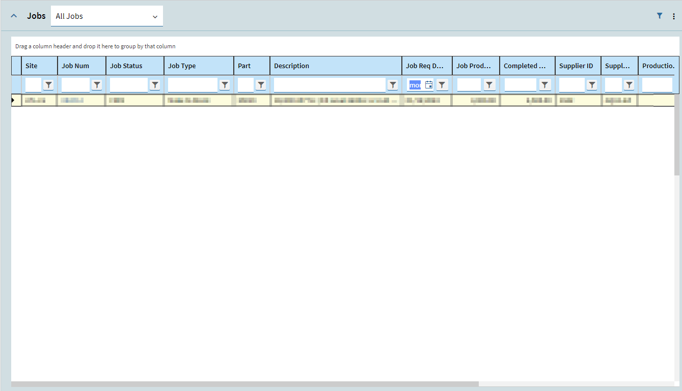

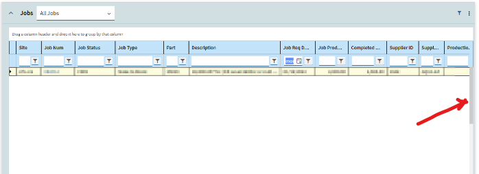

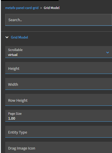

I tried setting the page size in my grid to 1 record just as an experiment. I have two problems: I don’t understand how to get the next page of results to load. Plus, the page size seems to be ignored when maximizing the screen for some reason.
Either way I know my query has several hundred records and I want the screen to initially load 100 records, and then give the user some way to get to the next page of records. Or even if I could just get that progressive load button to show up that Epicor has on their landing page to download all the results and they could use that to get to the rest of the results.
Initial screen load, honors the 1 record setting but no next page control:

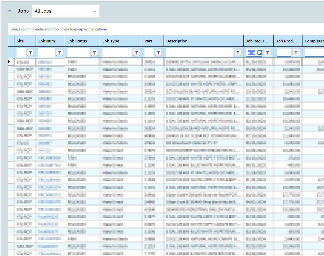

After maximizing the screen, page size goes out the window, but still no next page control:
Can’t say I have any experience with these settings… but notice you DO have a scroll bar.
If you scroll down, it will show one record at a time. (glitchy and bad… but it works)

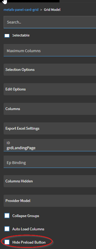

I moved over to a different app… the last setting in grid model is to HIDE the Preload Button… but the preload button isn’t there to begin with on my custom (BAQ) grid, and that setting is unchecked.

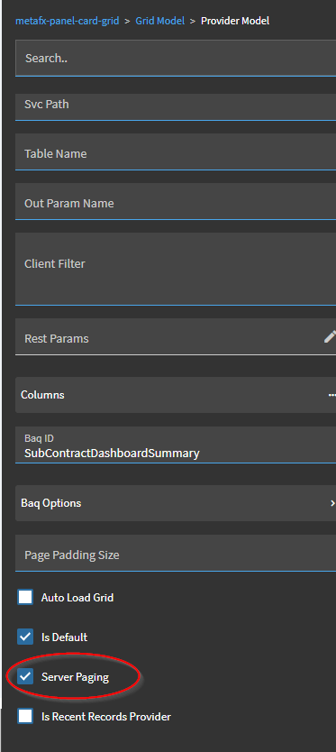

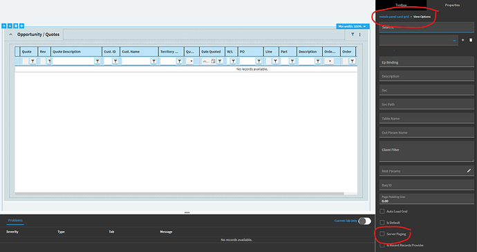

I found if you go into Grid Model > Provider Model… towards the bottom, there is an option for Server Paging.
That turns on the Preload button.
Nope. I already had both those settings set that way and there is no preload button.

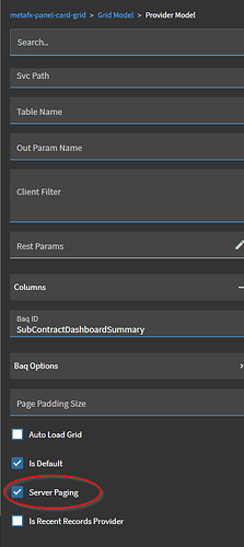

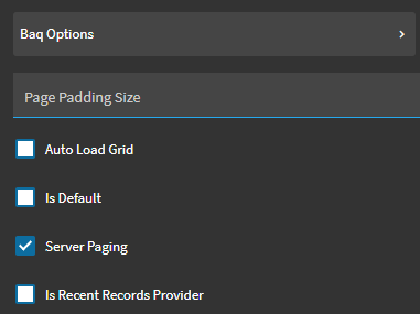

The Server Paging is also an option in the View Options. I’m not using Views on my grid… so perhaps it works on the Provider Model setting.
In your case, see if it is checked in your View Options.
Don’t have any views on this dashboard.
Looks like you do:
I don’t, in my case… so my View Options on my grid are all greyed out.

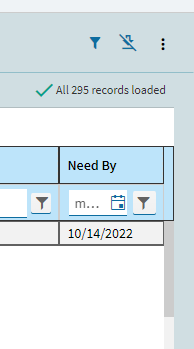

You know what you’re right, that did it! I have my progressive load button now. THANK YOU
