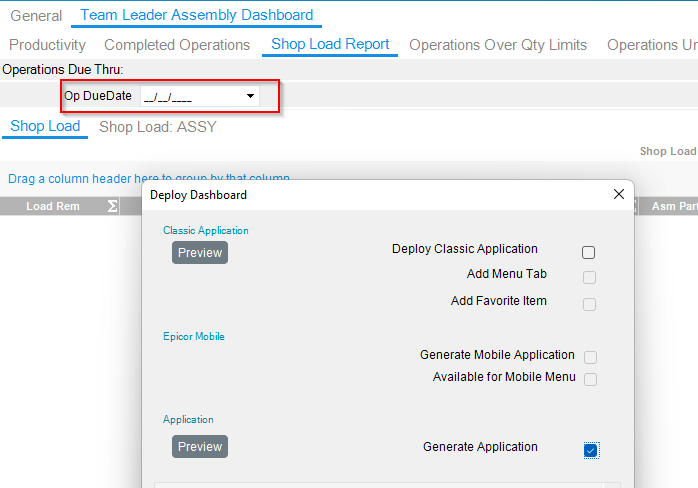

Here is a Classic version of the dashboard we’re sending to a Kinetic app:
This opens a slider on load of the form. There are a number of queries and grids in this dashboard, but it opens the tracker filter only on the first query, but that’s another issue.

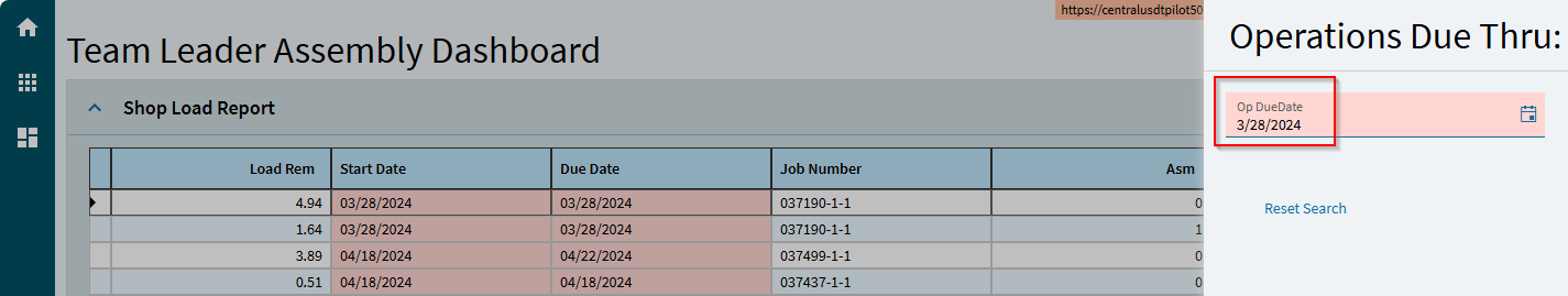

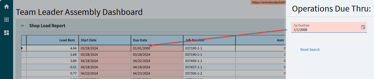

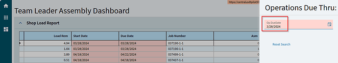

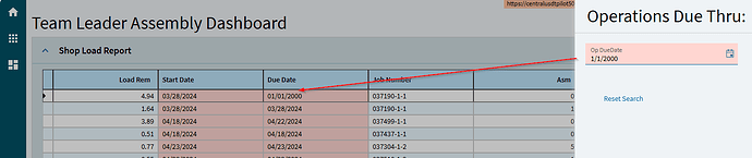

I guess that’s okay so far, but then when I enter a date in the filter field it just gets inserted into the first row on the grid:
Once I close the slider and hit refresh or refresh grid, it ignores the filter and runs the query wide open.

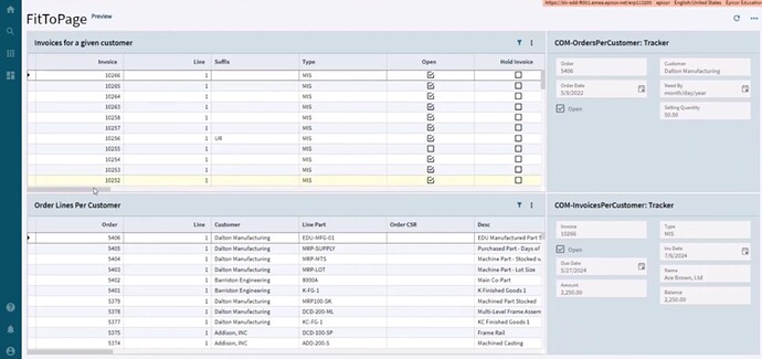

Good News in 2024.2 the Trackers can be on the Grid instead of slide out and they fixed alot of stuff! We are currently testing it in Controlled Release.

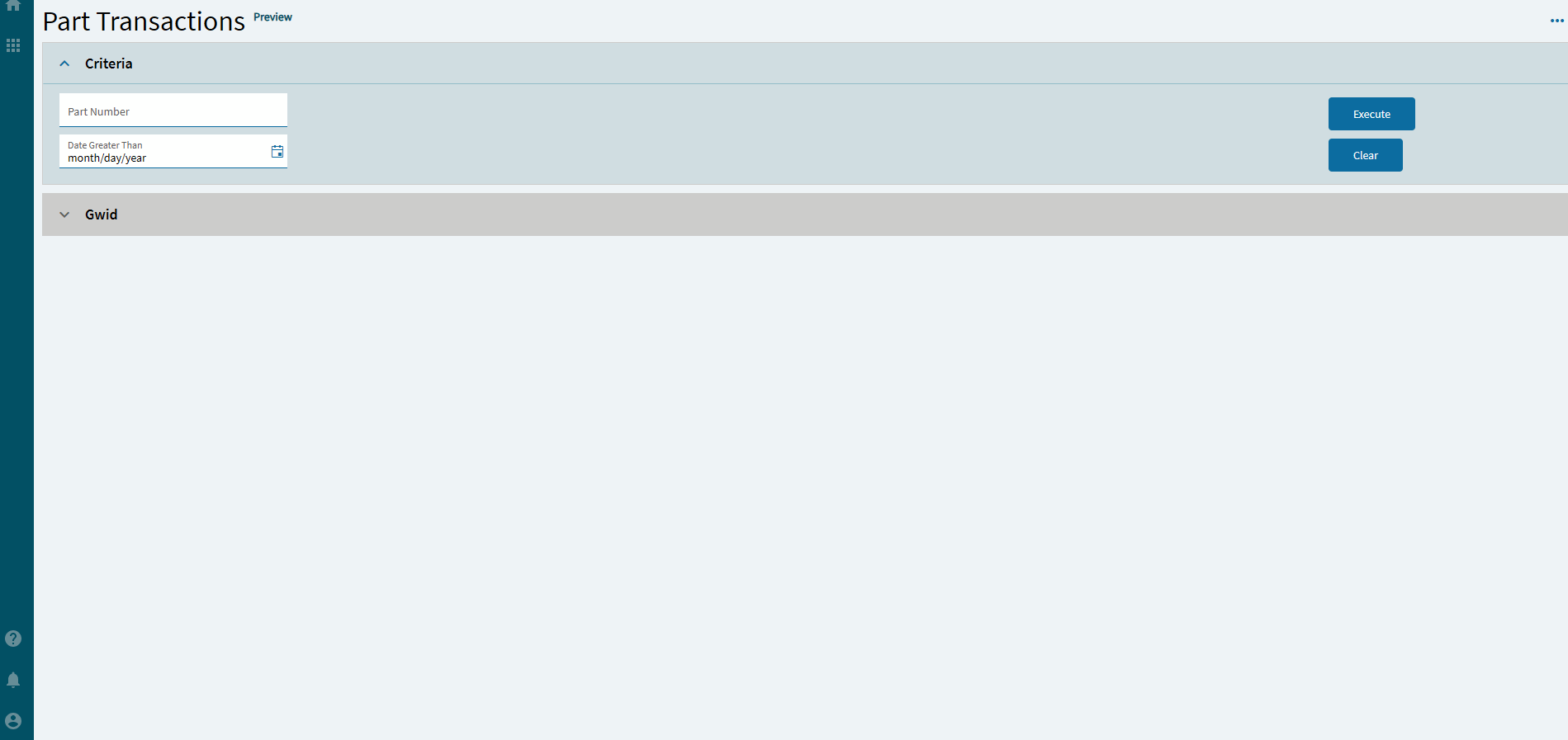

You can do this in any version. Just takes some minor refactoring.
You can control this by collapsing the grid on load and after a clear or even column changed. You can create a button that says “Execute” or something that expands the grid after your criteria is entered which would then fire the BAQ call with your filters. Similar to how you have to click “Refresh” in a classic dashboard.
Example:
DashboardControlledExecute
