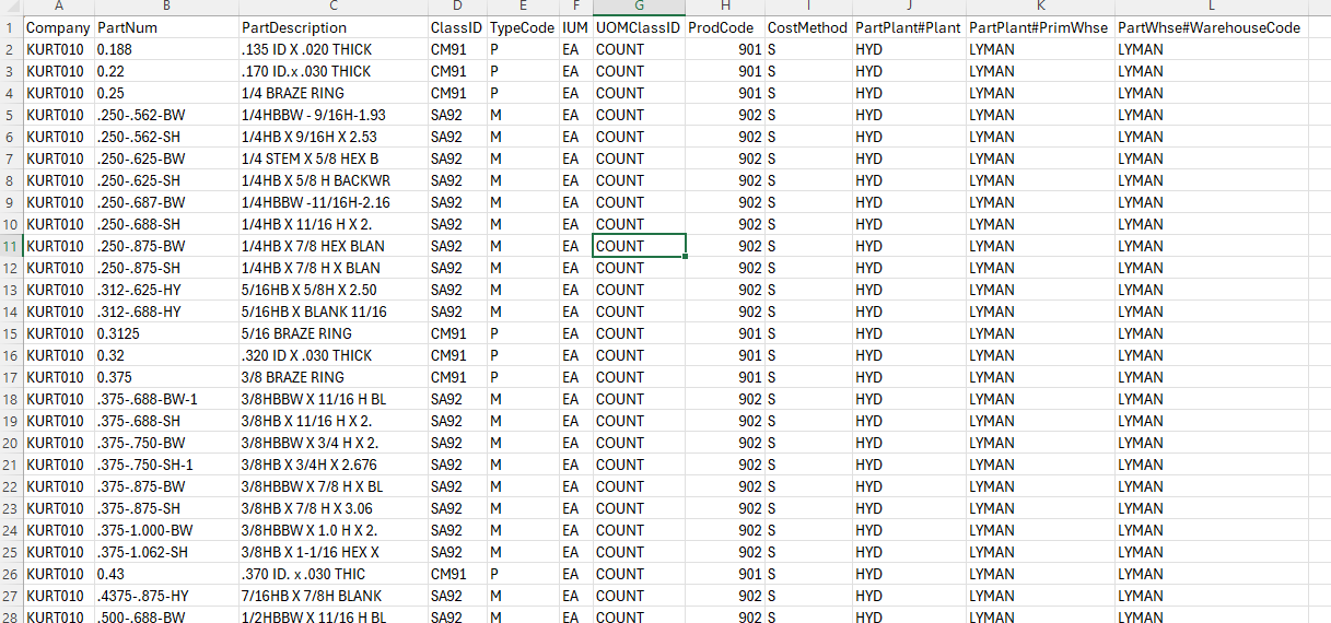

We are new to DMT and trying to load our part numbers in the Kinetic ERP system using the Combined Part template. The problem we are having is that DMT will not set the correct site for the part in our multi-site environment. The only way we have found to get around this is to run DMT for each site at a time after we have logged into the Epicor client for this same site. Doing this seems to populate the part table correctly, but we have 5 sites and would like to run DMT in one shot versus 5. Below is the Combined Part template that we are using when having this issue. Any help from a DMT guru would be much appreciated.
